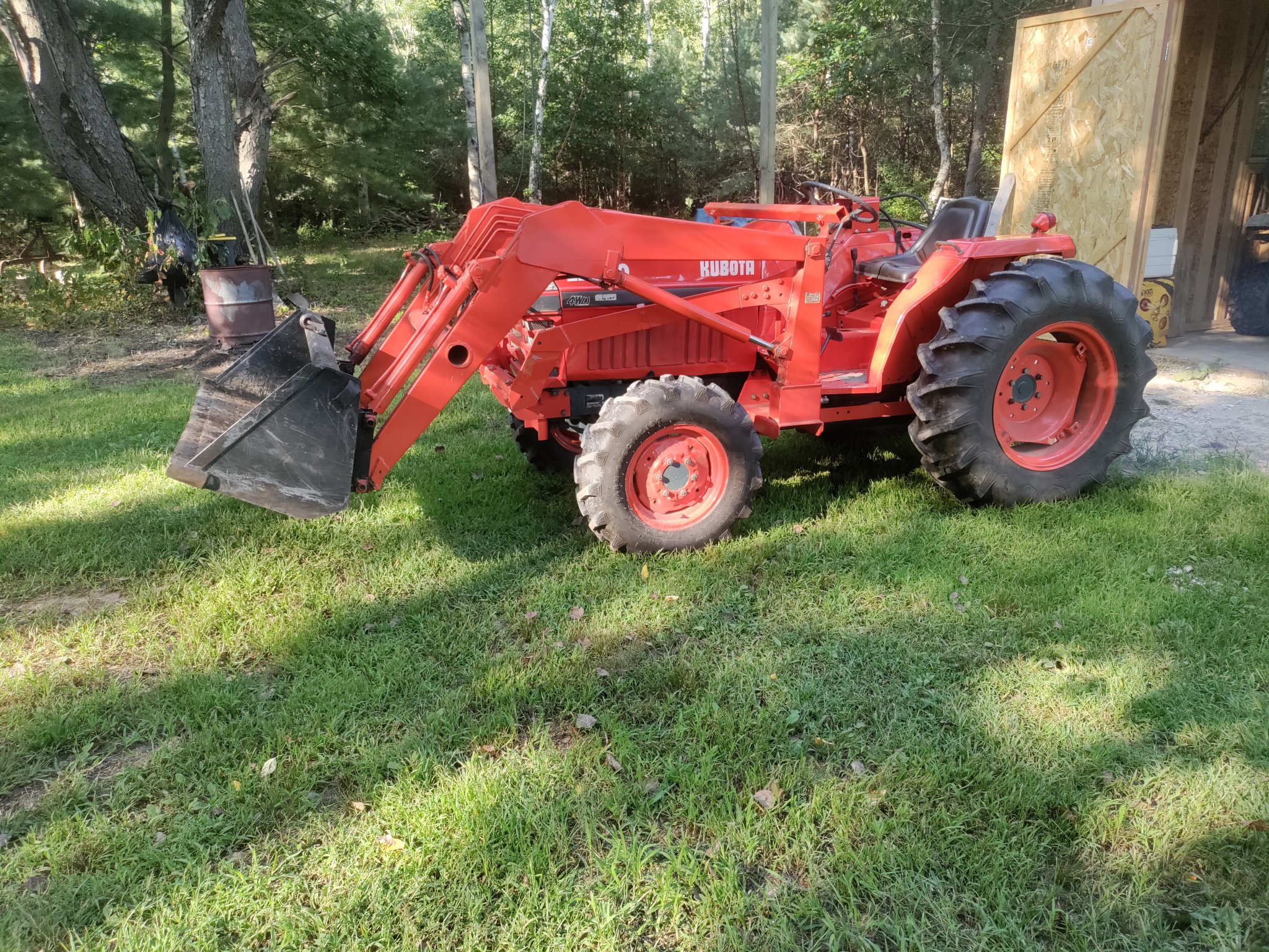

The loader has been painted over, so no markings. Here are some pics when I first bought it. I can take some better ones tomorrow if needed. IMG_20220826_174407.jpg

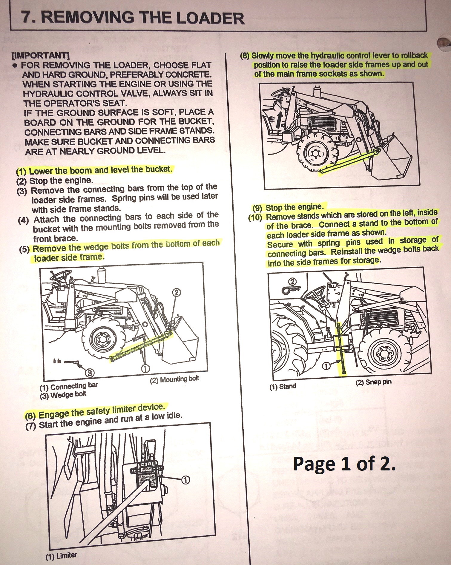

According to the manual:
1.Remove the stands which are stored on the left, inside of the front brace.
2.Connect a stand (2) to the bottom of each side frame (1).
3. Secure with snap pins used in storage of connecting bars.

But I can tell from the bucket....the loader is designed to be removed the same as mine. You are just missing the kick-stands that insert into the bucket and the other two 'props' for the far end. See below for basic instructions. I can post pics later today of the parts I believe you are missing and some basic measurements.

The operators manual should still be available and will be the best source for information.
Kubota: BF400 BF500 Loader Operator's Manual, Part # 70761-63315

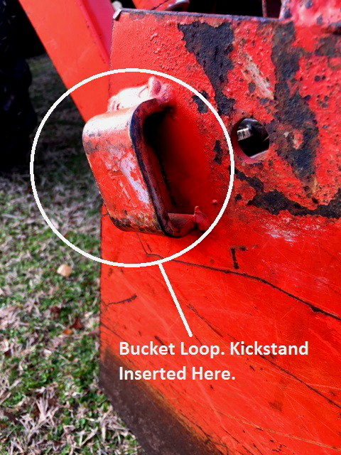

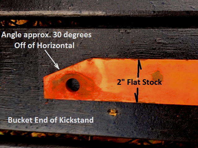

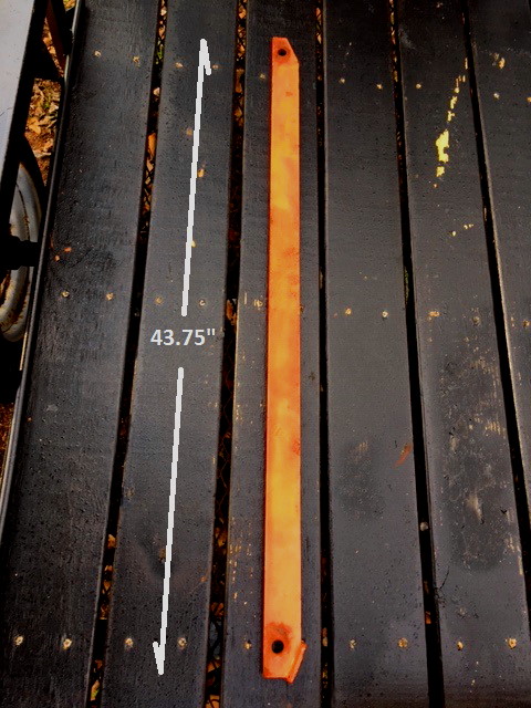

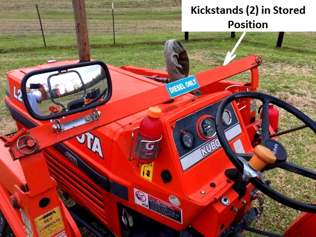

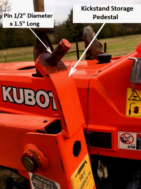

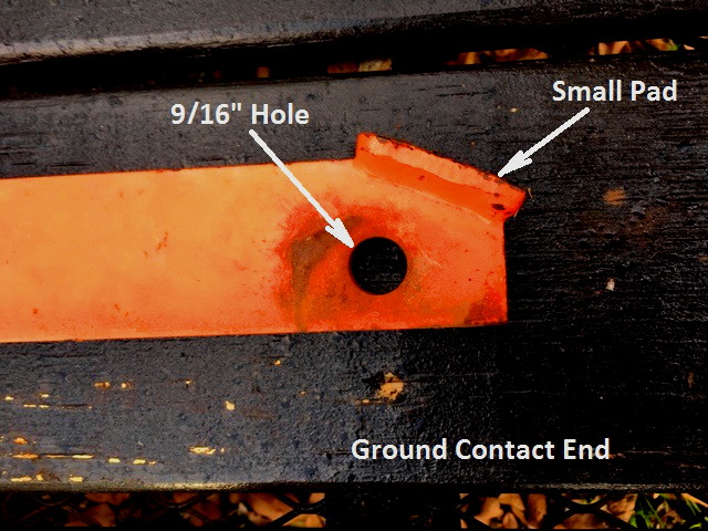

Mine (L2350DT) has two 'kickstands' that insert into loops on the bucket. 'Mine' are stored just above the dash on a couple of pedestals with pins.
FEL removal1.jpg FEL removal2.jpg FEL removal3.jpg FEL removal4.jpg FEL removal5.jpg FEL removal6.jpg

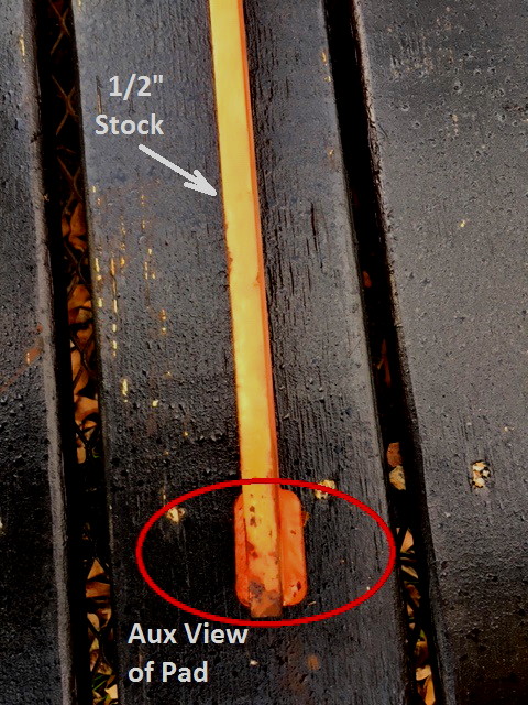

Mine are made from 2" flatstock that is 1/2" thick and have small feet/pads on one end where they would contact the ground. The holes are 9/16" in diameter and fit over the 1/2" diameter pins on the pedestal mounts (one stacked upon the other). The center to center spacing of the holes would have to be determined by YOUR mounting pins.

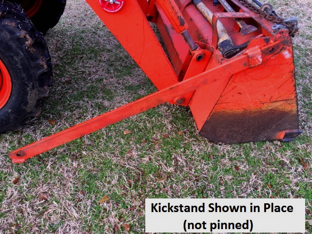

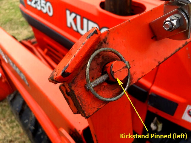

The kickstands on mine insert into the bucket loops (one on each side) and then the bucket is curled backward to lift the FEL base out of the pockets (wedge bolts previously removed).
Here you can see one of the kickstands in place (but not bolted).

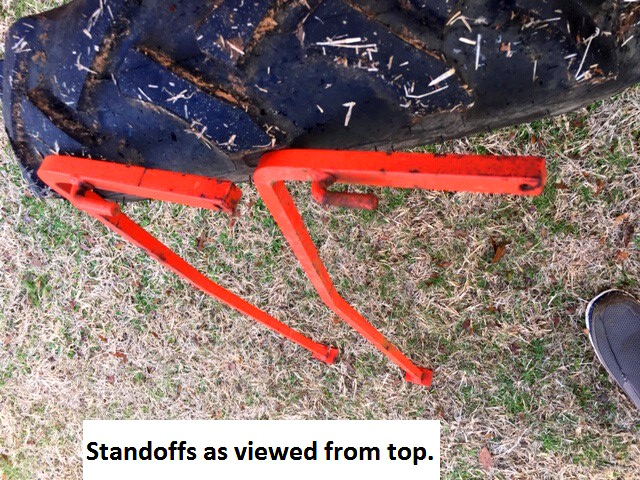

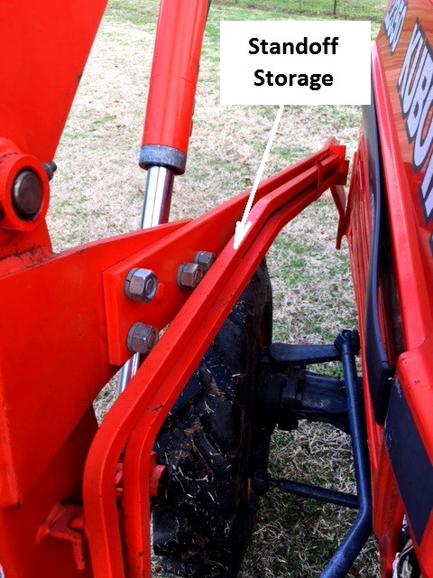

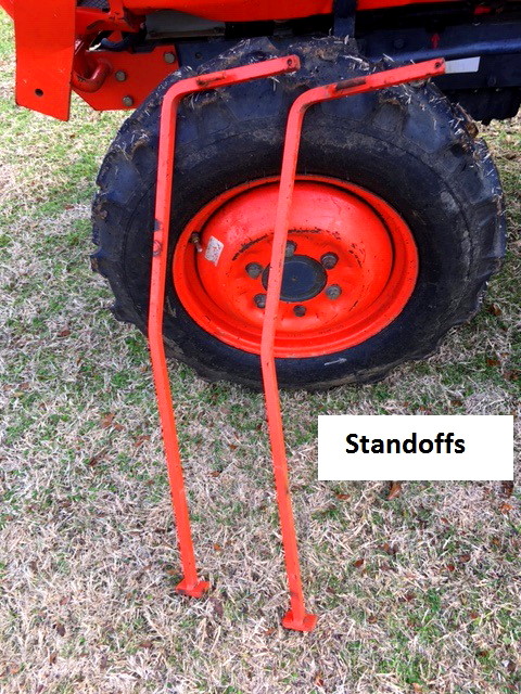

Mine also has a couple of 'standoffs' that help to balance (and perhaps support) the far end of the loader. I don't know if they are completely necessary but Kubota supplies them and gives instruction for their use. Mine are stored on the tractor as below.
This is what they look like. They are approximately 33" tall overall. They are identical, (no left or right).
View attachment 94078 View attachment 94079
This what they look like. They are approximately 33" tall overall. They are identical, (no left or right).
View attachment 94082 View attachment 94083
Thank you very much. The kick stands are there. I will only have to come up with the standoffs. With those great pictures I should be able to come up with something.

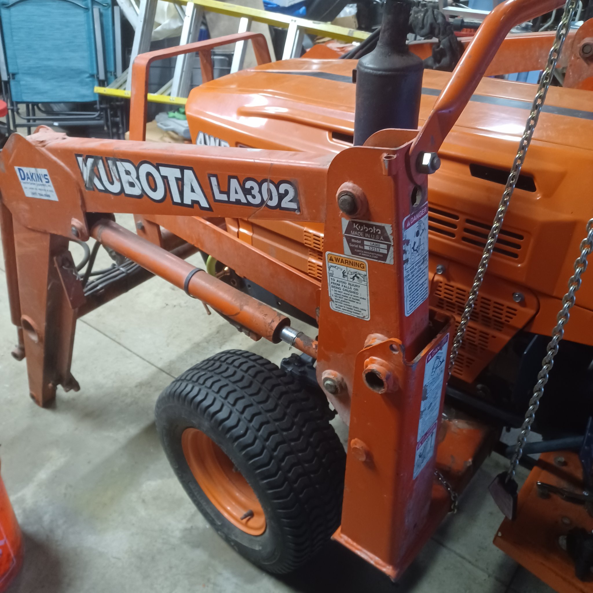

My used LA 480 Loader on a L3300 came with the standoffs attatched
to the loader arm and as much as i tried could not figure out where or how to attach them just in case I wanted to remove the loader someday.
Now i know I am missing or haven't found the 2 kickstands yet.

My loader isn't the exact model of Flintknapper's, but the kickstands were exactly where his are, crossways the tractor, just in front of steering wheel.
Mine just has a length of 1 1/2" tubular steel in front of the steering wheel attached to the loader side frame.
No kickstands to be found. Probably won't be taking the loader off anytime soon anyway, if at all. Nice to know what I will need though.
