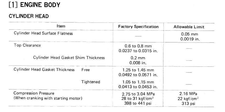

Ran compression test on cold engine, (30 F) and all 4 cylinders were right at 300 psi. Gauge had 20 # increments so that is as accurate as I could determine. Looks to be at bottom of recommended pressure. Surprising it starts so well, and seemingly has plenty of power. Must have been a beast when new. LOL

Guidelines for compression testing:
33,391
8,705
Surprisingly you really won't notice the HP gain when the compression is up to snuff.
You will notice better torque, and much better starting!

Diesel compression testing equipment will be tomorrow. Won't be able to test at operating temps, as I removed intake/exhaust manifolds, and hence injector lines. Going through gp fittings. Question is, should I do the 1ml oil on cylinder test also. That seems like a very small amount to measure out. Perhaps a dropper with 15-20 drops?
Now that you have a baseline (300ish) is when you would add 1 or 2 ml of 2 stroke oil to each cylinder. If your compression improves then you need rings. May as well do a top end at that point anyway. If they are all at 300 again, then you need a top end.
Either way, you don't need a new engine. You need an engine builder.
33,391
8,705
IMHO with 300 PSI dry it really doesn't matter what the wet number is.
You need to rebuild the engine, and with the numbers that low, along with oil issue, I would plan on doing cylinder liners too.
In other words complete rebuild! ;)
