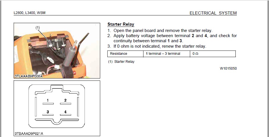

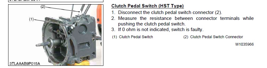

You have not done the important tests shown in my earlier post.
It is not suddenly going to fix itself.
There are more involved voltage drop tests you can be given but all require you to have a multi meter and know how to use it.
