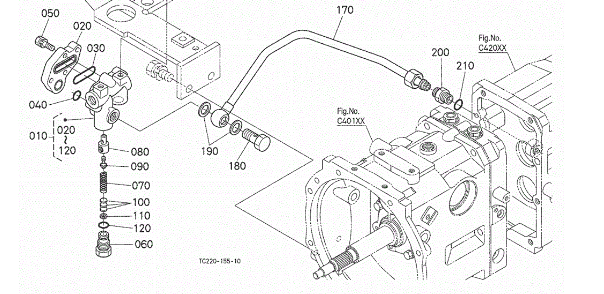

Next thing to check would be the system relief valve. (60-120)
I would check over these connections one last time for oil leaks.
