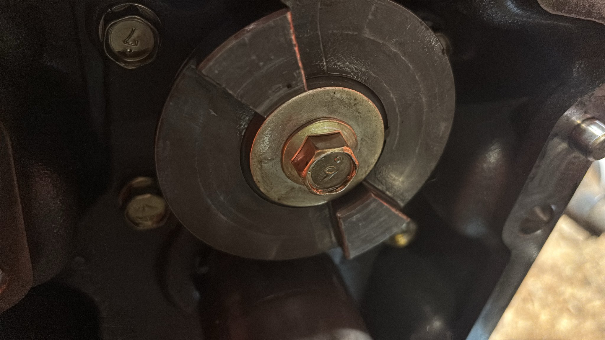

The Serial number break for locking cams; for L2800DT/HST - serial number 57745-up; L3400 was 61733
Are you above that?? It doesn't really go by "years"...
You said PTO "chatter"; my guess it's the Cams... You would be the first I've heard about needing a PTO clutch job!
Let me know, I can post what another member bought to change out his PTO cams, I've seen the price for $45 a long time ago, I bought my set for $112 and for fun, I just looked up the current price, $154...
I have not done mine... had plan to do it last winter. Looking at next winter time project.

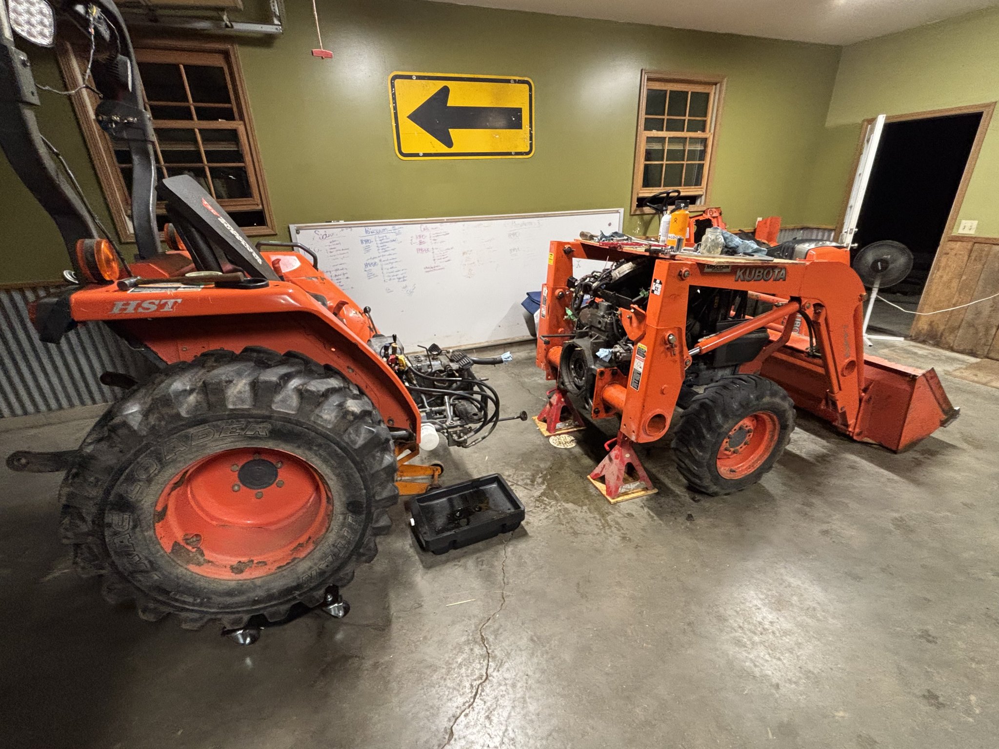

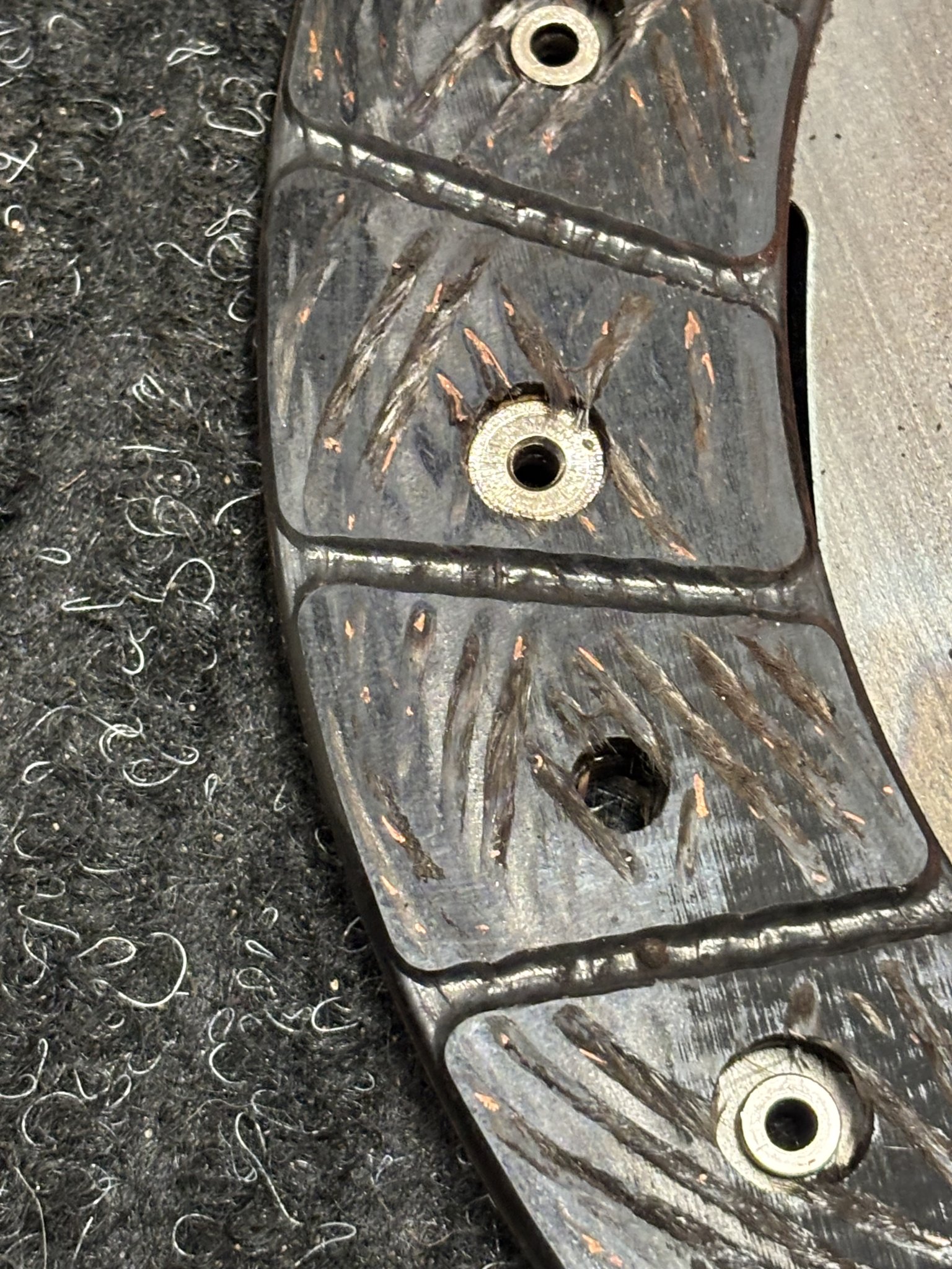

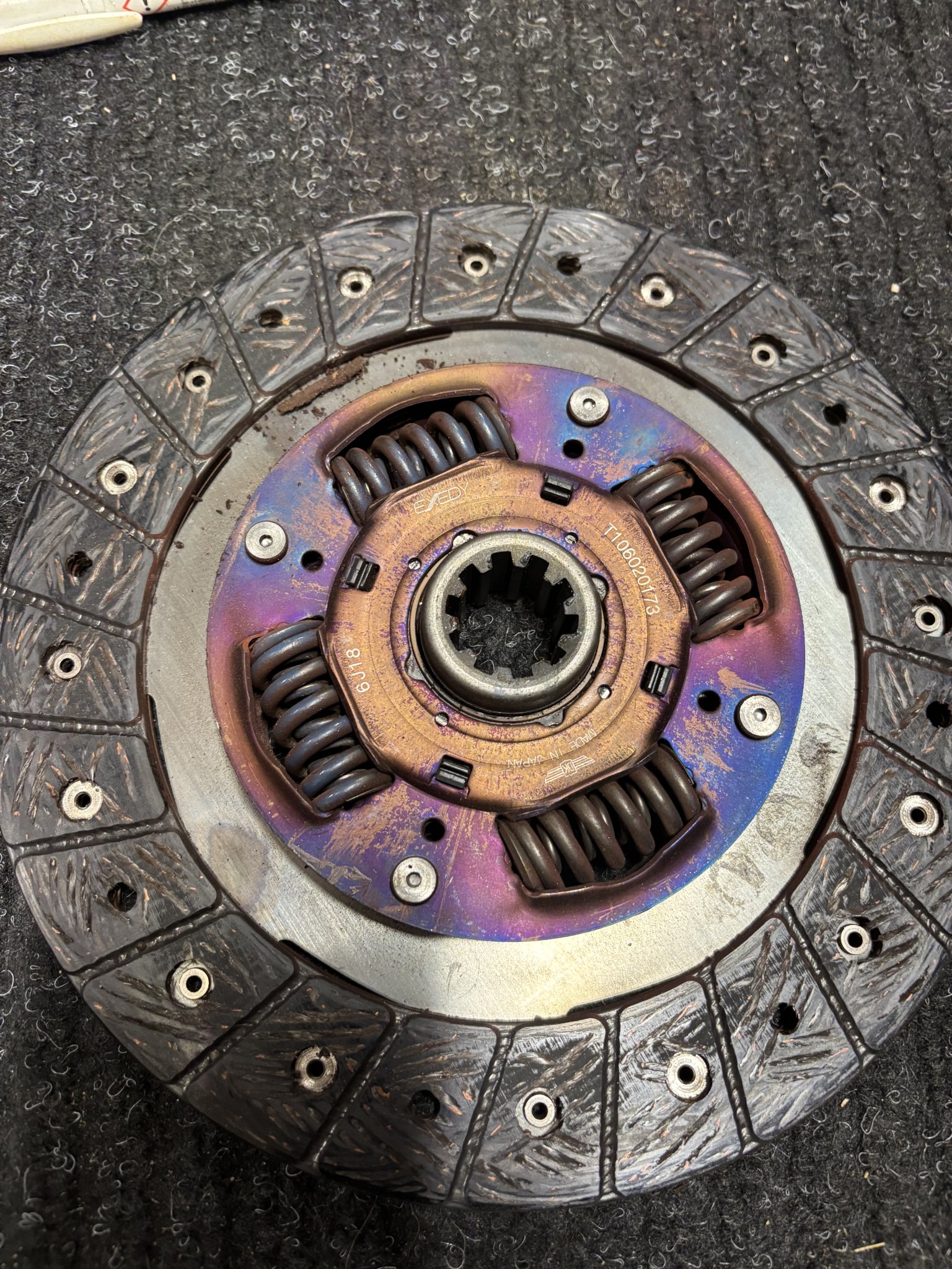

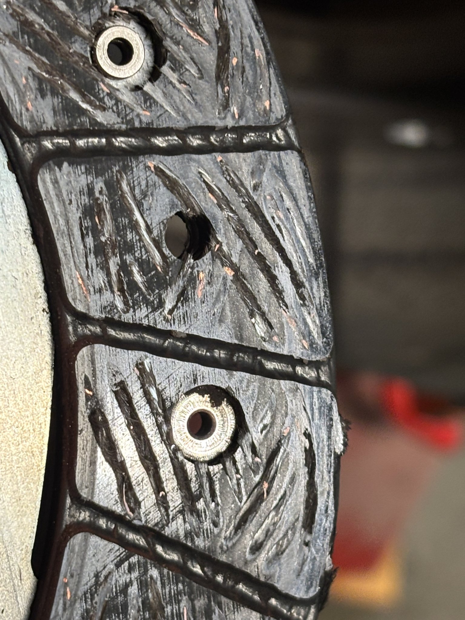

You have a fried clutch disk or pressure plate! ;)
Who told you the hydraulic pump had anything to do with the PTO operation? :unsure:
6,400
2,043
I like the large arrow telling you which way to move the rear half! Don’t forget to turn it around during re-assembly! :D
(just joking with you so please take it as a joke not an insult as many people would)

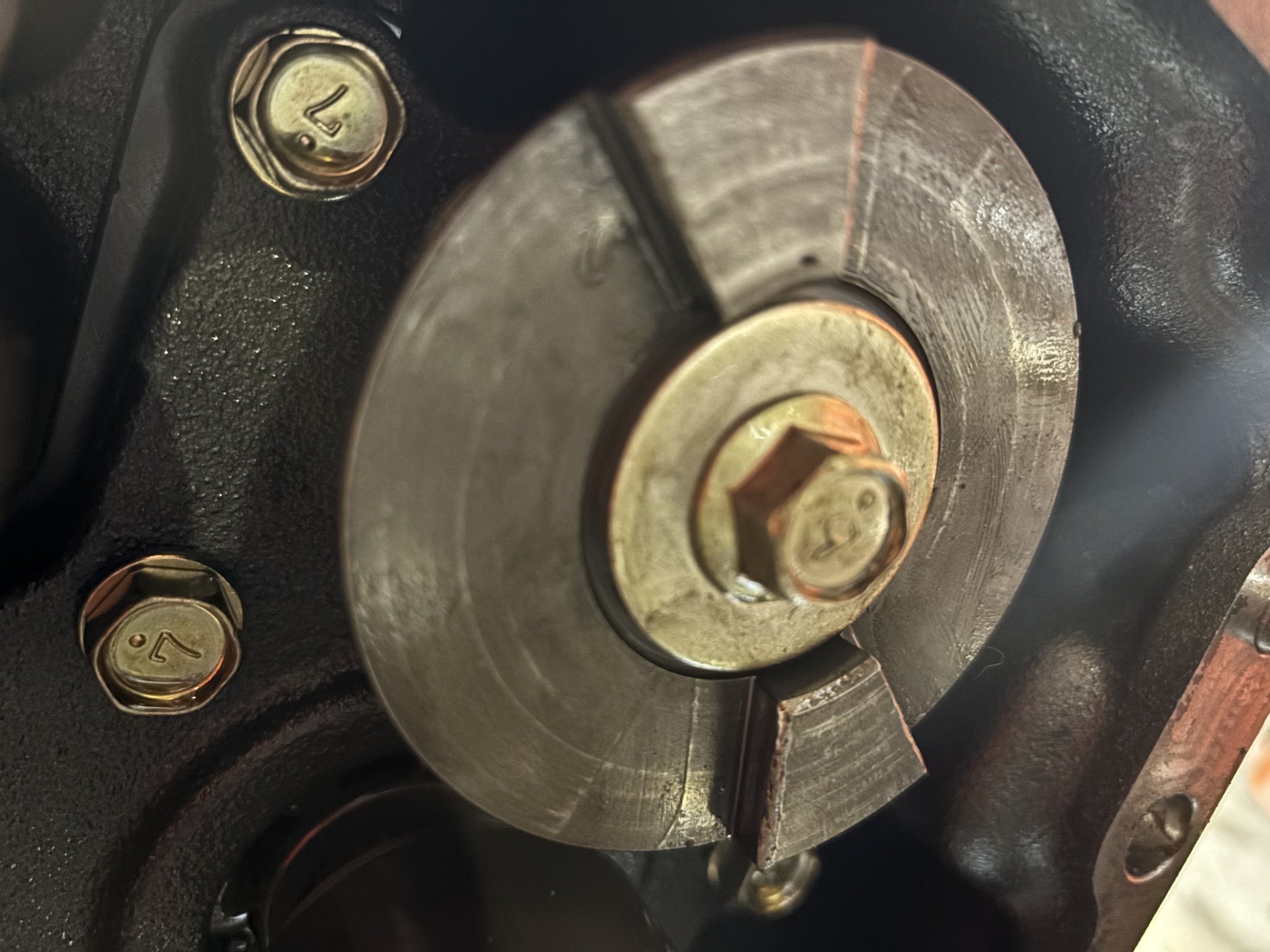

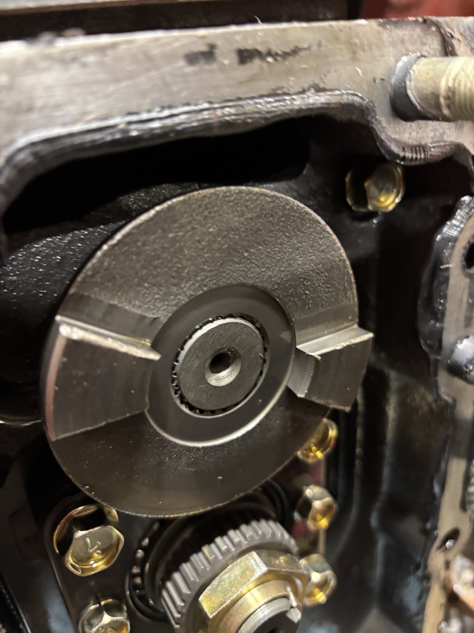

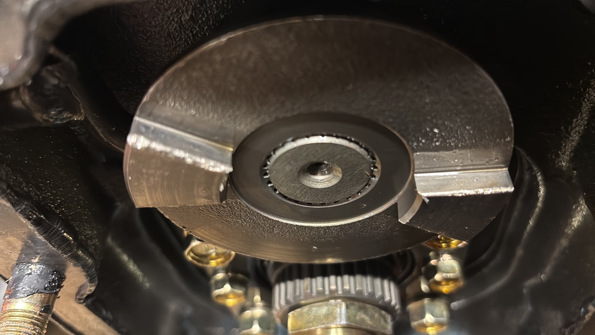

My only question now is do I replace the PTO cam clutches while the tractor is split? according to the serial numbers i already have the updated clutches.
old and tired
L2800 HST; 2005; R4
Not the worst but slightly nicked up... Are you replacing them or leaving them?
Someone asked a long time ago about re-surfacing them? No one had an answer to that...
One guy who changed his out had a problem with lining up some gears, his solution was wrapping a thin string around the gear so that he could rotate it when putting it back together. (just in case that happens to you, too)
