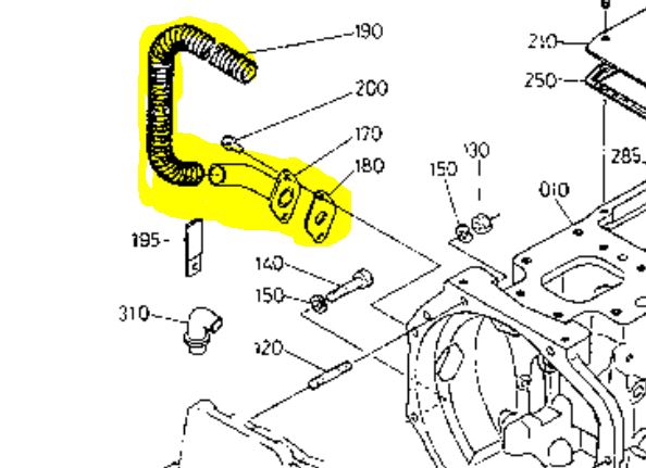

Here is an page from the manual (I'll send you a link to download the whole manual) to adjust the clutch.
The hole to adjust it is under a elbow pipe bolted to the side of the case.
If you have a loader, a lot of the subframes cover the hole.
