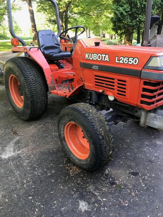

The tractor also has turf tires, with the original 355/80d20's on the rear and the put 235/75R15's in the front (which I believe now are too large).

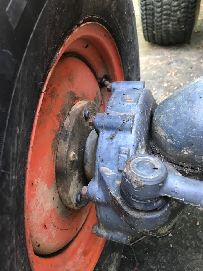

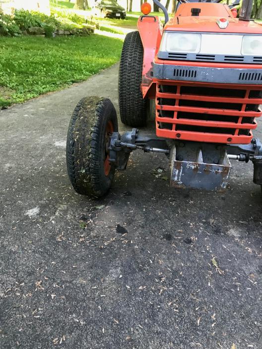

In trying to narrow the tractor back up (I have flat land with trees), removing the spacers from the rear was obviously no problem, but when I tried to flip the front tires "cup in" I found that they bind up on the Tie Rod ends.
It seems my only good option is to find some 16" wheels and tires (size?). I can add 3/8 inch shims behind the existing wheels to clear the tie rod bind, but then the wheel doesn't engage the lip of the center hub. I doubt that is a good idea, even without using a loader or front weights.

It is the rims that rub, if you look closely at the front rim in that second picture you can see the silver ring that the tie rod ground into the rim (before I realized what was going on). The tractor would move in reverse, but as soon as I went forward it would rock forward and bind.
Then for the spacers, I am at least sort of using them for the moment. Again, if you look at the picture, you can see I re-used them on the outside of the rim just because I only had the long lug bolts to put the wheel back on with. Once I get the right length bolts, I'll let you know

I suspect that the front rims are not kubota, or not for that tractor.
Hence the reason they rub.
2 options: Get spacers, or get the right rims, rims might not be an easy task.
