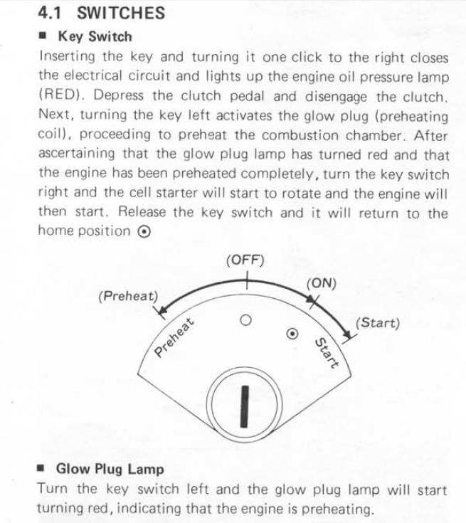

Your question concerning the key switch positions makes me wonder if you know how to preheat the glow plugs.
See attached page from a different model's key switch. Yours may be the same.
Are you seeing the glow indicator glowing red?

So no. The glow indicator does glow red. However the tractor has a key switch and a start switch. Left on the start switch should be preheat for the glow plugs, and right is to engage the starter. I took them out and turned it to preheat and got a little smoke off them.
I'm just not sure if the other key switch positions do anything different or if they are all just on. The wires on the key switch are to the lights and the ignition.
