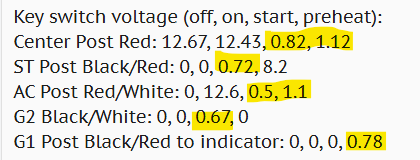

Key switch voltage (off, on, start, preheat):
Center Post Red: 12.67, 12.43, 0.82, 1.12
ST Post Black/Red: 0, 0, 0.72, 8.2
AC Post Red/White: 0, 12.6, 0.5, 1.1
G2 Black/White: 0, 0, 0.67, 0
G1 Post Black/Red to indicator: 0, 0, 0, 0.78
Started at ST post and moved counter clockwise around switch when viewed from the back of the switch.

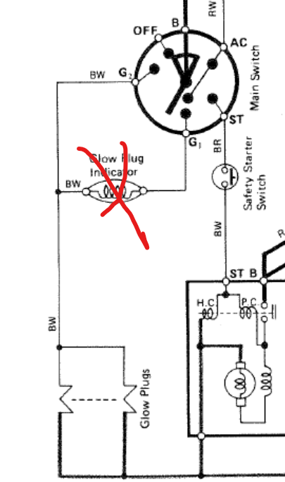

Your better off just wiring it like this and be done with it:

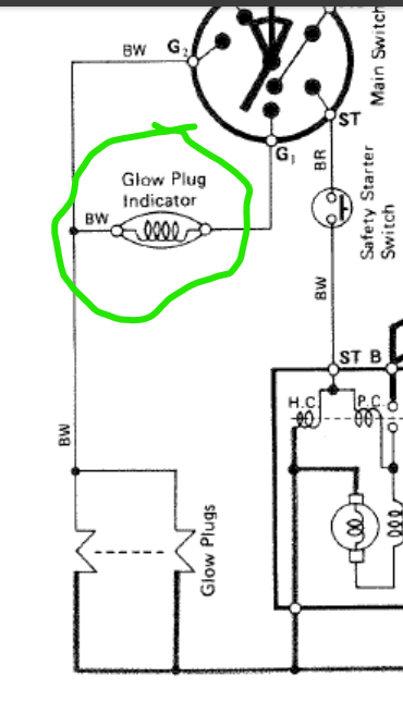

Well there's possibly your problem 2 fold!!
#1A That model does not take a glow plug indicator, someone added it.
#1B That model did take a glow plug indicator
#2A Someone has replaced it with the wrong indicator (there is different ones depending on how many glow plugs you have)
#2B Someone has completely wired it wrong, it should not go to ground, if it was right it would be wired in series to the glow plug buss. You sure it's not wired that way?
We need to see if you have the easy checker or not.
If it doesn't have an easy checker this is right.
If it does have an easy checker this is wrong.

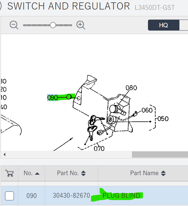

This is the easy checker gauge cluster with the 5 dummy lights, right?
I'm not sure if all of the tractors come with a hole for the indicator, but this one appears to not be a hole somebody drilled at a later date to add an indicator because the hole is factory punched not drilled. There is paint all the way around the hole surface. Not bare metal like you'd get if you drilled it.
I've not located where the ground side of the indicator goes yet. It disappears between the indicator and the fuel tank and I'm still searching for it.

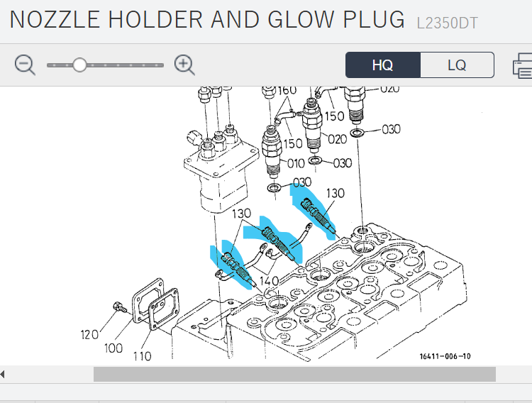

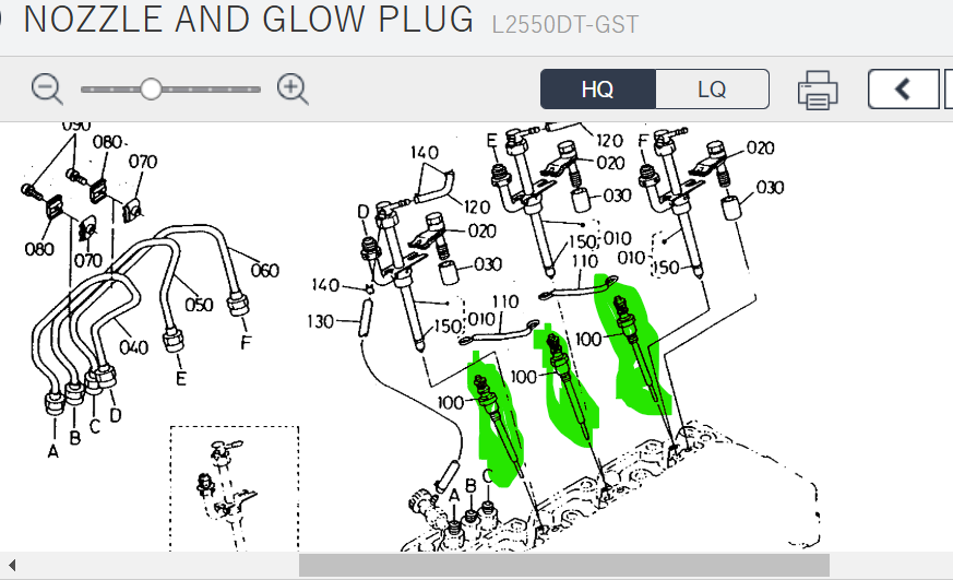

Ok here is the total answer:
These style glow plugs take an indicator:
Like in a L2350
This style of glow plug does not take an indicator:
Like your L2550
The hole is factory, that hole was for a horn switch on UK models.
Your L2550-GST
Like in a L2350
Like your L2550
I can't tell which type of glow plug I have. The injectors are the style in the picture where you highlighted with green, but without removing one of the glow plugs I can't tell which style I have.
On second look, the bus bars on mine are the z shape like it shows in the picture you highlighted with green. But I'm not sure if that is enough to positively identify them.

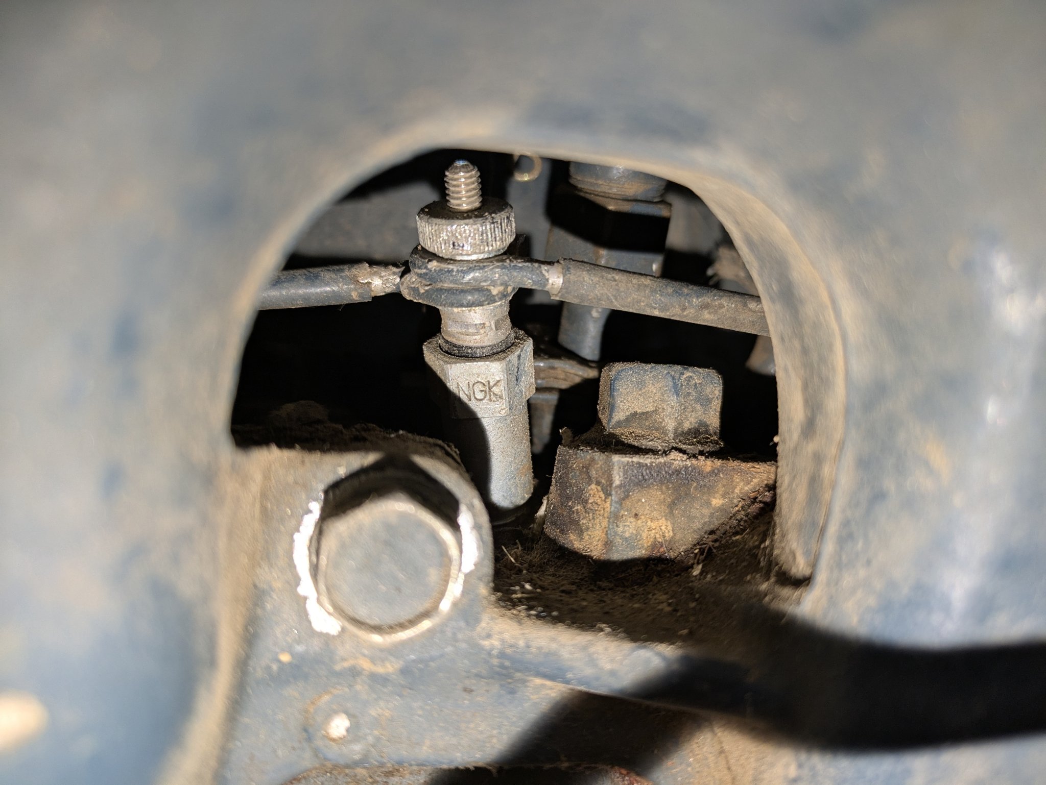

Here's a pic.
36,724
11,443
Here's a pic.
They go hand in hand, You have pencil injectors so you have the long glow plugs that are the non indicator glow plugs.

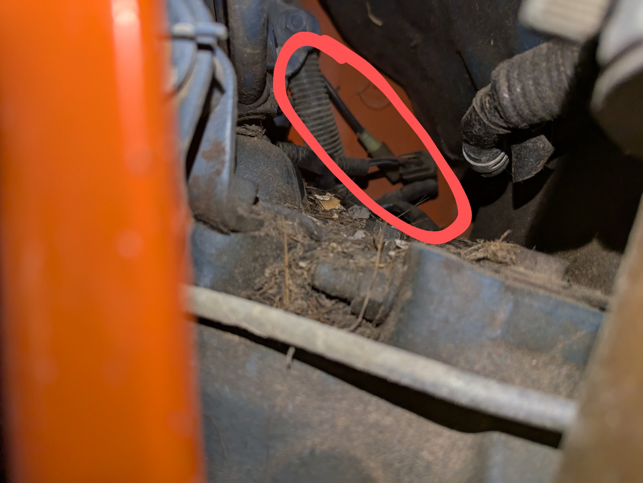

The ground side of the indicator is connected to the harness connector on the left side of the steering column under the fuel tank as shown in the pic, but I don't have enough panels pulled off of the tractor to trace it any farther through the loom. With that said, the ground wire does not look factory as it has crimped connectors on both ends. But the wire on the positive side of the indicator is a factory wire that is in a condition that indicates it's been there a long time.
If I'm going to end up deleting it then I'm not going to try to trace it any further.

This is all confused because Kubota changed engines from and IDI (indirect Injection) to a DI (direct injection) after the original manuals wiring was made for the IDI.
You need to make sure that wire doesn't go to the glow plugs.

All you need to do is make sure G1 and G2 both go to the wire that goes to the glow plugs, then it will work properly. 😉

You should get 12V on both G1 and G2 with nothing connected to the other end of the wire.
There should not be a relay for the glow plugs on that model

If your measurements below are accurate I would be surprised the engine even turns over.
The measurements in yellow show an incredible voltage drop in the circuit feeding the switch. If wired as per the schematic with the indicator you should see somewhat less than 12v at the buss bar during preheat and close to 12v when cranking.
Regardless the glow plugs are not you starting issue. A direct injected engine should start at well below 40F without any starting aid. This is even stated in the WSM. 1737035808935.png
Most DI engines do not have glow plugs.
If I were to guess I would say you either have an issue with cranking speed or compression with a lesser possibility that the injectors are not atomizing fuel properly.
