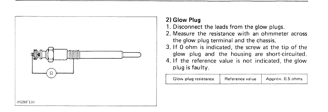

Your glow plugs are in spec:

yessh, 1/2 ohm so will draw 25 amps +-, EACH ! Hope you got REAL good battery 'under the hood'

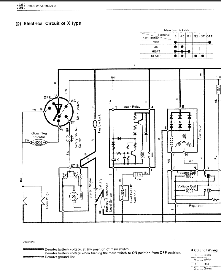

OK, curious, I pull an L2250-2550 WSM and it shows the 3 glowplugs in series BUT... the GP test from NIW post shows 'tab to ground'..which would indicate a parallel circuit and 75 amps...
are there 2 different L2550 tractors ??
33,708
8,920
No there is not mutiple different glow plug set ups.
ALL glow plug circuits in Kubota's are parallel, exception of the very very old models.
Just have to look at the flow print and not the wire color print.
13,037
5,741
thanks for clearing that up. sad 1st 2 diagrams are wrong... neighbour had an 'old' Kubota where gps were in series, many hours spent on that......
now I'm impressed that switch handles 75 amps !

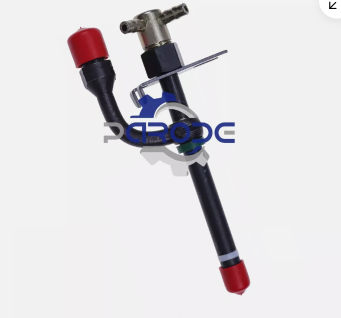

You've got to be careful, this is one time that the "rules" don't apply.
The injectors for this engine are not the same injectors as 95% (guess) of all kubota engines.
This tractor and a few others in the same time frame used Pencil injectors and not Cartridge injectors.
Pencil injectors typically are considered non rebuildable, even though some they have rebuilt ones.
Pencil Injectors:
It's still possible, but I've have very few bad off the shelf of these type injectors.

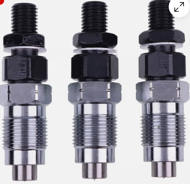

Cartridge injectors:
A lot of these injectors are bad from sellers.

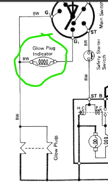

Ok, back to trying to fix this. I think the 6.7 volts I'm seeing at the glow plugs is too low to heat them. So I guess I need to chase the voltage through the circuit and see where I'm losing it. Also need to check voltage at the GP when they aren't turned on to see what I get.

Anybody know what this chrome thing in the pic is?
Looks like a glow plug indicator.
Is it wired to the glow plugs?
13,037
5,741
Using NIW post #23, check the wiring.
Put DVM/DMM set to volts on the glowplug 'bus' and ground
Turn key to 'start', you should read 10-12 volts.
Then put meter on battery and do same, what is the voltage ?
33,708
8,920
That's what I thought it looked like but this tractor has the dummy lights below the gauges which I thought meant it wouldn't have a mechanical indicator as well.
I'm digging into where it's wired to now.
What compression tester type is used on this engine?
Its the glow plug indicator. I believe the glow plug circuit runs through.
The wire in the indicator heats up and will become red (with enough time) and is visible through the small hole.

The indicator reads 0.78v during preheat, 0v otherwise. It does not ever glow, did preheat for 25 seconds to verify.
One side is wired directly to the key switch to the pin that says Gr or G1 maybe, it's hard to see. It's a black wire with a red stripe. The other side is grounded.
33,708
8,920
Well there's possibly your problem 2 fold!!
#1A That model does not take a glow plug indicator, someone added it.
#1B That model did take a glow plug indicator
#2A Someone has replaced it with the wrong indicator (there is different ones depending on how many glow plugs you have)
#2B Someone has completely wired it wrong, it should not go to ground, if it was right it would be wired in series to the glow plug buss. You sure it's not wired that way?
We need to see if you have the easy checker or not.
If it doesn't have an easy checker this is right.
If it does have an easy checker this is wrong.
