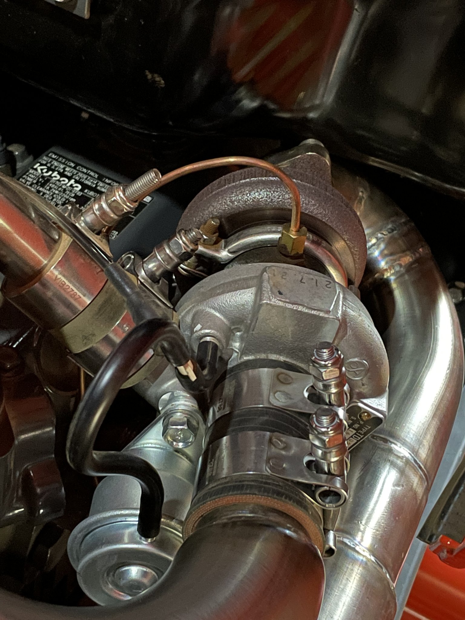

Perhaps a silly question... In your description of the installation design and the process of installation I'm not sure I read about how you sourced oil to pressure lube the turbo. Did I miss this?
Also... just a casual observation from a different industry. EGT readings are highly subjective. They are subject to large variations based on probe location. In one test we saw a 50 degree difference in EGT reading when we moved the probe from one side of the exhaust pipe to the other - all other variables were the same. Distances between the exhaust valve and probe, angle at which the exhaust impinges on the probe... all these little things produce measurable differences in sensed EGT. I only mention this because you have discussed EGT in terms of absolute values when, in fact, those absolute values can only be meaningful when comparing identical EGT probe locations.
Now you've got me thinking that my little B2410 might need some "help" making more power to deal with heavy snow-blowing loads. Ohhh this is the kind of thinking that gets me in trouble!!!!
In a perfect world you should be reading temp right from the exhaust port on the engine. Realistically preturbo in the exhaust manifold, preferably in one of the hotter running cylinders.
I'm reading the EGT temperature pre-turbo in the Turbo adapter, which, in this case, appeared to be the best compromise.

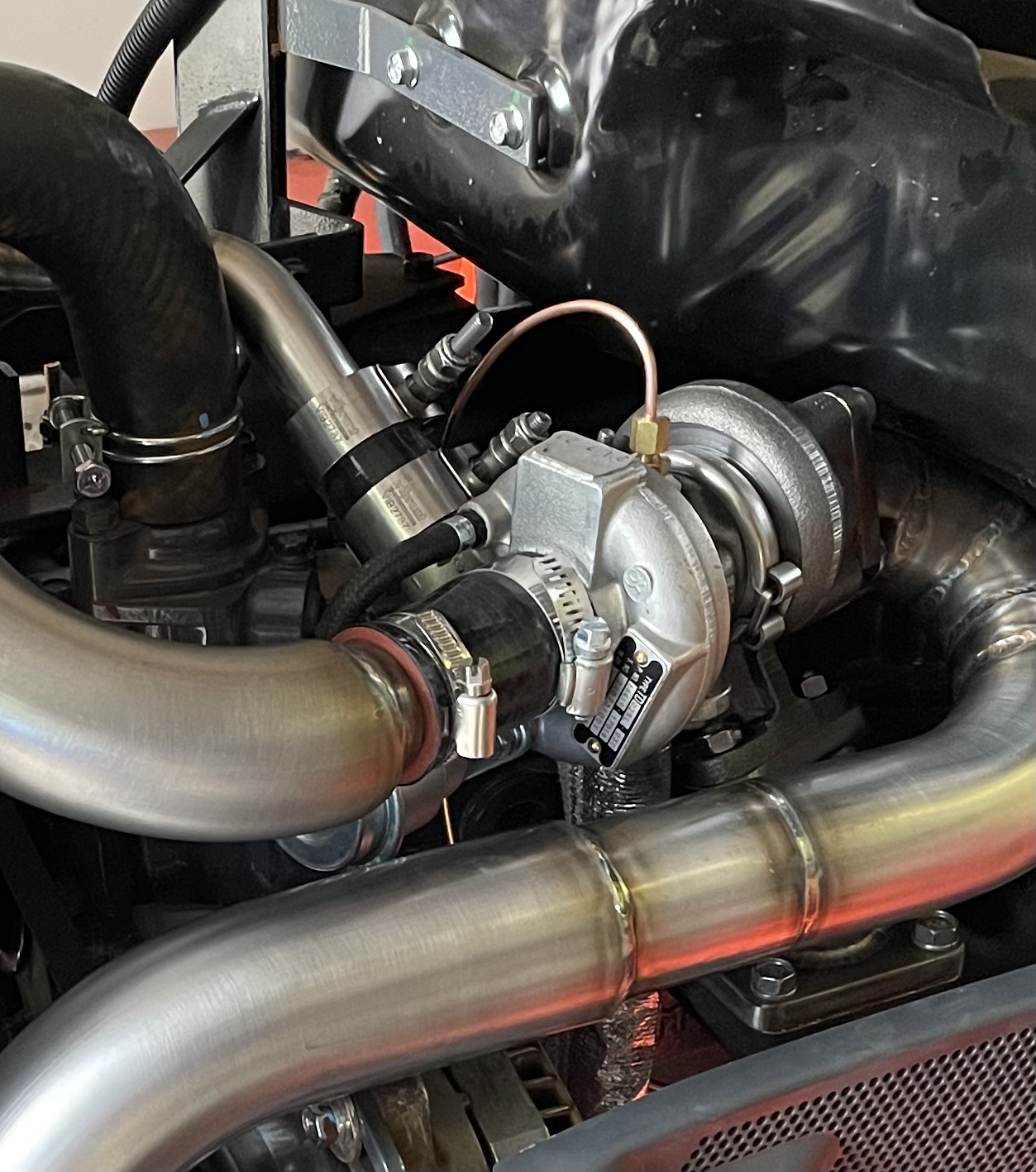

Tractor is continuing to run strong with more than enough power to accomplish all tasks. I haven't experienced any hiccups or issues with the Turbo setup installed.
I'll be installing a couple new hose clamps on the Turbo inlet pipe to match the other clamps and I'm considering installing some steel-braided lines for the Turbo oil feed and drain.
Mike

Before;
After (new T-clamps);
Swapping the hose clamps was solely done for aesthetics. Obviously, this small modification wasn’t necessary. The old hose clamps work just as well as the new T-clamps. I just like things to match and look ‘clean’.
Mike
