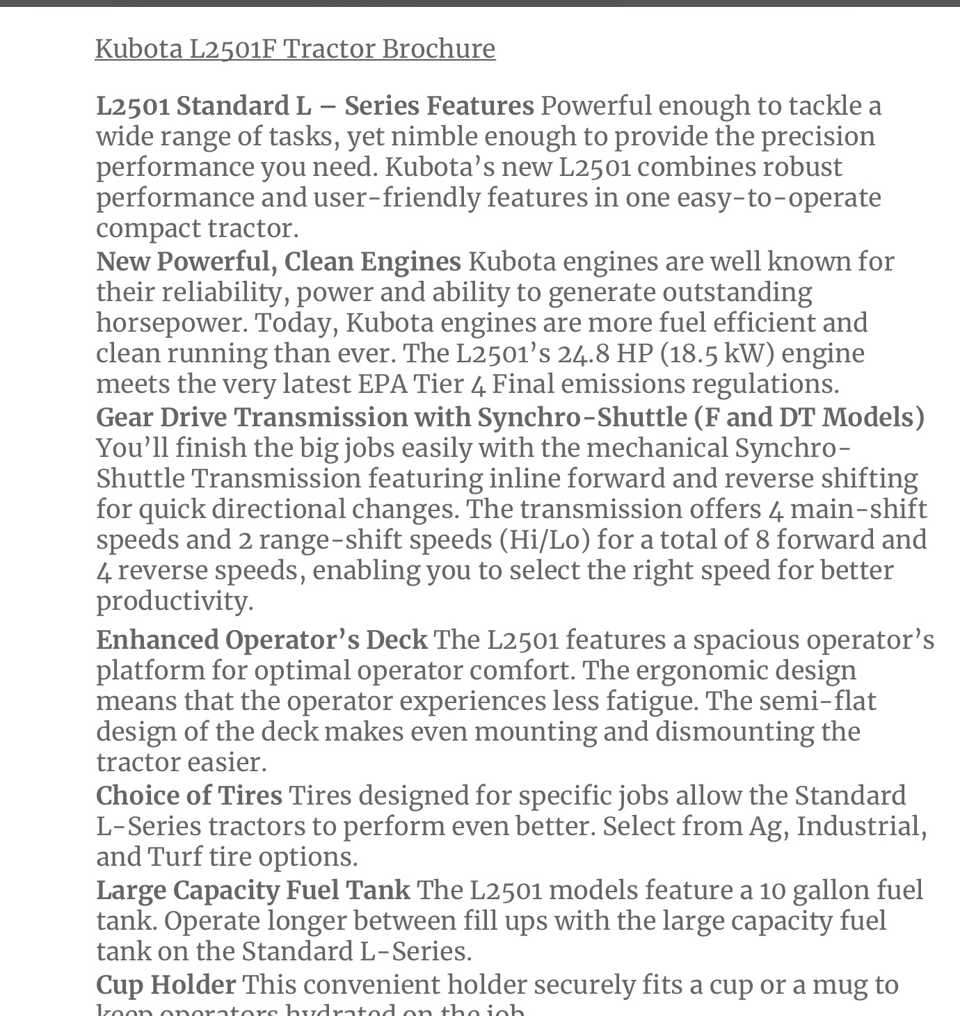

Figured I would muddy the waters, LOL.
Found this from a Kubota dealers website. L2501F. Not sure if Neal's tractor has the F designation or not. The features say the F and DT models features a synchro-shuttle transmission.
