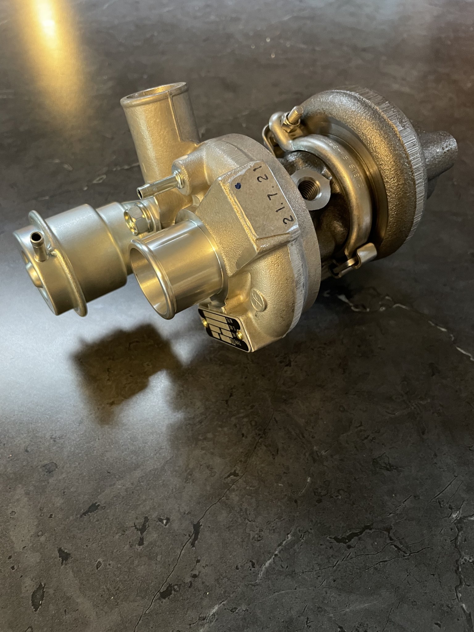

And…look at what arrived yesterday…
…a brand new Mitsubishi MHI Turbo!!!!
