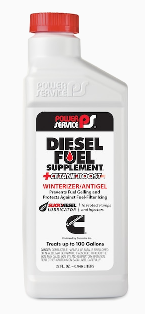

Sounds as if you have a fuel delivery problem......
Let me ask you this .......... going "up hill" - what range are you in L - M - H ??
IF your fuel gelled - it would slow down the delivery of the fuel going through the filter. Change your filter and try this:
this will be locally available

I am in "M" going up the hill.
I will change the filter and get a bottle of the stuff show above and report my results.

I checked the springs on the brake petals underneath the tractor. They looked fine to my untrained eyes. I put some diesel fuel stabilizer/injector cleaner in the fuel tank and changed the fuel filter. This resulted in improved power but not quite to normal. I am wondering if it might take a while for the cleaner to completely work.
