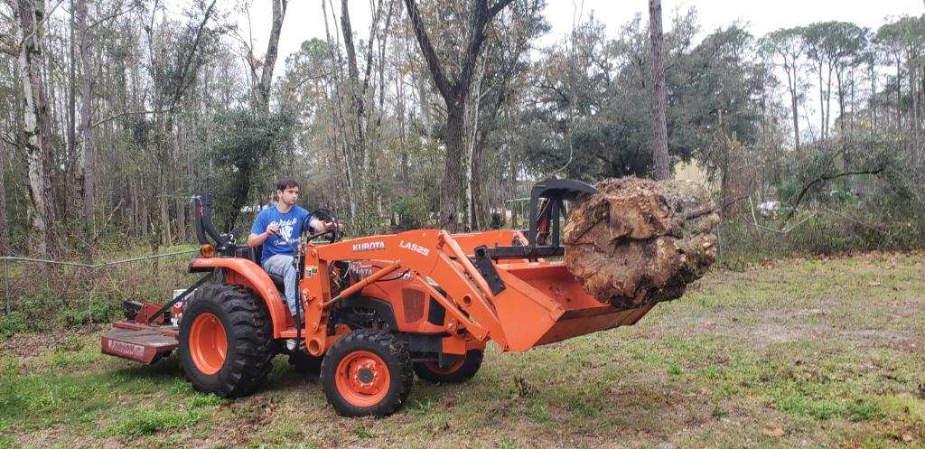

Hydraulic pump flow or GPM does not affect lift ability, it only affects the speed at which it happens.
PSI affects lift ability, hence why everyone want to turn up the system pressure. ;)
You are of course 100% correct. That is the bare knuckles truth. I was more making a generalization as PSI seems, at least in all my reading, to almost always correlate with an increase in hydraulic pump flow. The higher the GPM of the tractor, the higher the lift capacity and thus the higher the PSI. I don't have a full intimate understanding of the full underlying principles but I have always noticed the connection of GPM to lift capacity. I suspect the B2650 has a slightly higher spec PSI over the L2501, that would correlate with the slightly higher pump flow. I make that assumption because it has almost always been the case from what ive seen so far. In real world use though I dont know if the B2650 could outlift the L2501 simply because of the weight of the tractor. Even with several hundred pounds on the 3 point and loaded tires I can still lift the back of the tractor up with some loads. That would be even more an issue on the B2650, which is lighter.
