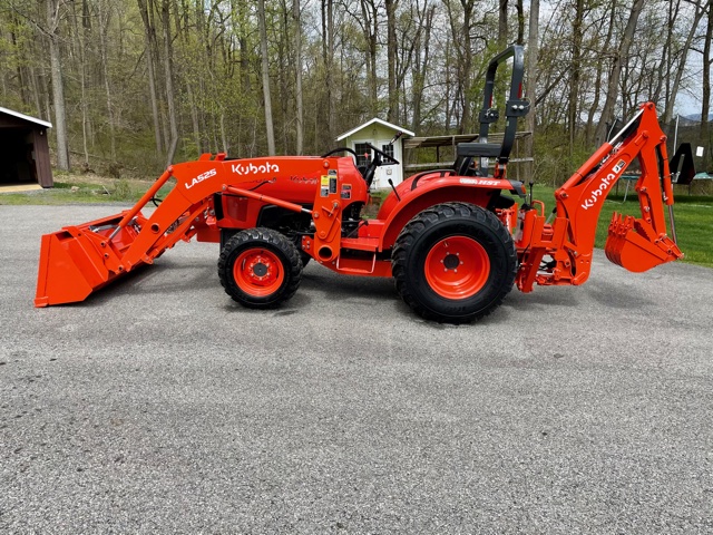

DELIVERY DAY!! Thanks again for all the info :cool:
- L2501 as TLB on R14s - also got the LP Grapple.
Spent the afternoon familiarizing myself with all of the controls and attachments. Went for a long slow ride on all my trails to test drive. It felt a bit big at first as I should expect being used to my little old Ford 1210 16hp with 60" mmm, but I became right at home after the first hour. All of the main tractor controls are exactly the same operation & position EXCEPT for the hand throttle is opposite high/low (ugh - that will take a while to break muscle memory). I preread the manuals online, but will definitely be referring back frequently, plus leaning on the collective great experienced group here :)
One key takeaway is that I really need to keep that swing of the bucket and BH in mind & focus w /tight quarters for sure. The loader was intuitive but definitely will need some practice & time on the BH as I was pretty awkward and slow to get it doing what I wanted. Going to test the grapple tomorrow...
You folks may appreciate this: I took a bunch of pics at delivery and was joking with the delivery driver about getting on w/waxing it as it was super clean and shiny. After he left and as I was warming it up (it was a very cold day here in mid-eastern PA - frost last night and prob again tonight!) I decided that was actually not a bad plan to give it an initial coat all over as it will never look this pristine again.
Here it is all clean & shiny:
And - after my trail ride having dipped the BH frame into the dirt on departure angle testing 4WD low & dif. lock...
AND then I did a "test dig" around a large old stump/mound and broke the v. paint seal on both buckets before dinner (no pics...) ;)
