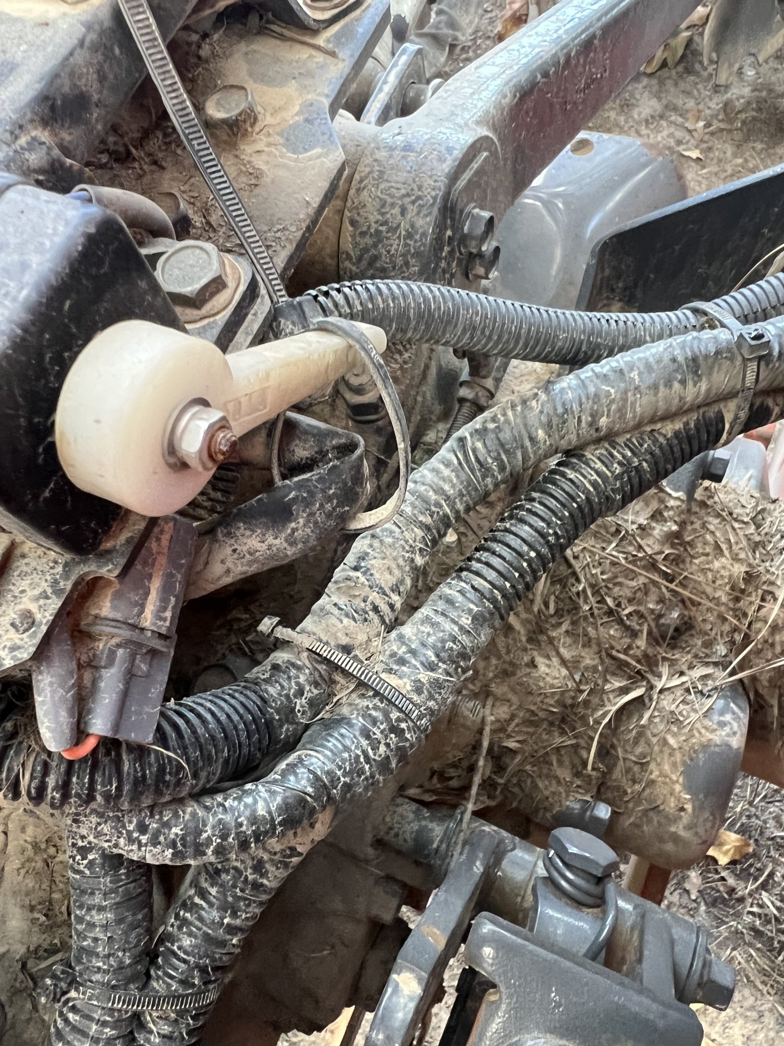

Can’t help on the clutch switch, gear drive doesn’t have one, but the seat switch I just zip tied the lever of to the harness…
Easy enough to slide it back off if there is a time you may want it to be functional though

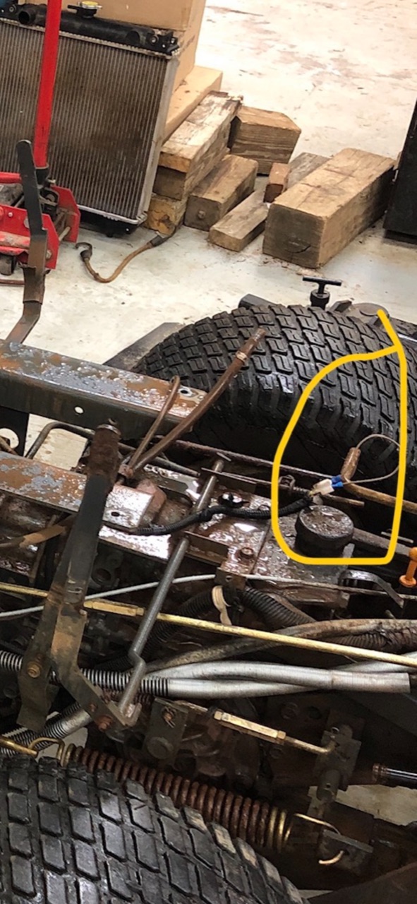

Depending what type of plug it is, I have a few made up at work “for testing purposes”. Male or female spade and a short piece of wire.
This is an F mower I had to pressure wash to find a hydraulic leak. Drove it around like this.

I have my seat switch zip tied and after seeing @Matt Ellerbee pic I made my own jumper. I was just looking for something cleaner. I think the clutch plug will be pretty easy to find. Seatbelt might be a little harder to find.

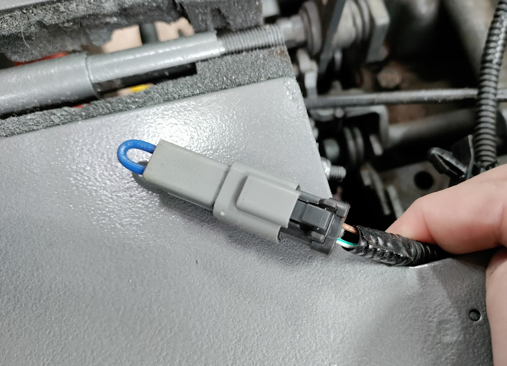

You'd have to look at your connector to see if there's any numbers on it. The seat switch connector on my B2560HSDC is a Deutsch DT04-2P on the seat side, DT06-2S on the tractor side.

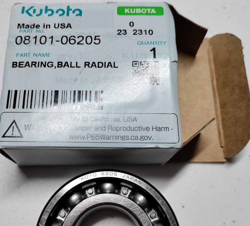

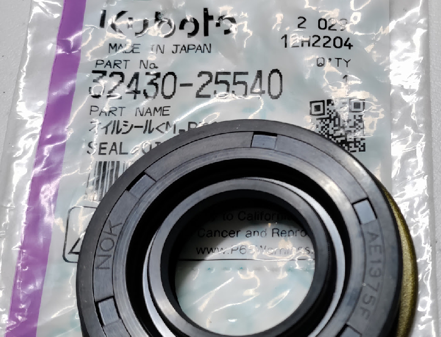

Just took pictures of a couple of examples-
Kubota 08101-06205
Mfg is KOYO 6205
Kubota 32430-25540
Mfg is NOK AE1375F

Those are aftermarket replacements and bearing says made in USA. I have never been able to find numbers on seals and bearings installed during manufacturing. I find that bearings from distributor outlets are usually less than half price and often 25% of those from dealers with vehicle/machine part numbers on package,not to mention close by same day availability. Only a few months ago I had to pay a machine shop to find replacement seals because the originals had no markings and was discontinued by Kubota.
SO I ask others. Are you able to cross reference then order bearings and seals for your Kubota from NAPA ,Rock Auto and bearing dealers?

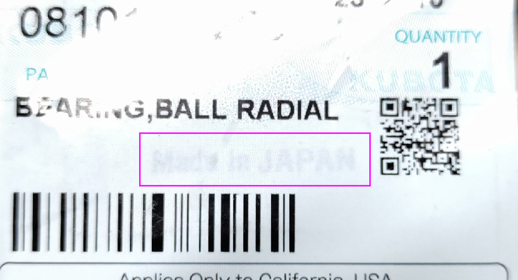

It's a Japanese bearing. The sticker you see is applied over the original sticker.

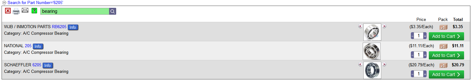

As for the 6205 bearing above, from Rock Auto-
6205 bearings are everywhere. It's an industry standard size.

G-r-o=a-n , I've already recognized those aftermarket parts in picture have industrial #s printed on them. I'm saying industrial #s haven't been on oem parts I removed from tractors in the past. I'm not up for a pizzing contest,I just asked if the majority of people find industrial #s on oem bearings and seals installed at factory. Maybe I'm the only one to ignorant to see them or maybe you are the only one brilliant enough to see them. I've asked the general readership about it so time will tell.

Whatever. I guess I'll pretend I didn't see manufacturer markings on the parts I've replaced.
Yes, I agree there are many parts where there are no markings- mostly the custom manufactured parts. There are also many parts that have manufacturer markings. Bearings, seals, and u-joints are usually off-the-shelf parts that already exist.
