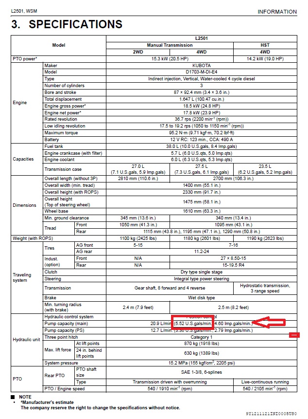

I'm looking to break up a bunch of big rocks on my property and was wondering if anyone has experience with putting a hydraulic breaker on the skid steer attachment on the loader of a L2501 tractor. I have the 3rd function on the loader and it looks to have about ~15 GPM flow. Some of the breakers need ~11 - 20 GPM flow to work. Anyone use one? Is it a bad idea?

I do not think you have anything close to 15 gpm hydraulic flow.
From the spec's it would be around 5
Dave
Yes, I missed that, thanks for the info. I was looking at the flow rate of the valves. Definitely not going to work with a breaker if the pump is only 5 GPM. Time to look for a plan B. Maybe a jackhammer and generator... or a rental.
