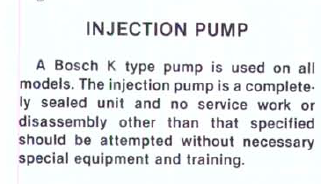

Thanks! I'm bit nervous because I haven't done this before but I hope I can do it. I have access to a decent torque wrench, any idea what is the torque spec for those holders?
There is no referenced torque values for that pump in that model.
This is what it has to say about this in the manual.
This is the referenced values from a newer pump, it is a very similar pump and you could safely use these values.
