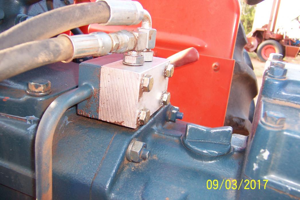

What does the Priority Valve look like on my tractor and where is it located? Is it the rectangular aluminum block centered under the seat on top of the rear axle? How can I know if it is working properly? Also what does the diverter valve look like and where is it located? Or doe this tractor even have one?
I bought this tractor from a mechanic who installed a FEL and never could get it to work properly. I suspect the added on FEL control valve was fed from the wrong source which blocked the return to the tank and over pressured the pump which split the side out. I want to be careful not to break the new pump and FEL control valve.
I have asked my local Kubota dealer for information on this this tractor but they will not help me over the phone.
They want me to bring it in to them, or for an arm and a leg (probably more than the tractor is worth) they will come from Mesa to St. Johns (a 5-6 hr. drive one way) to pick it up.
I am in hopes that someone here might be able to shed some light. Many thanks for any help on this forum, Kubota Knerd

Pictures of the setup now would really help.
The priority valve should be on the left side next to the three point lift.
Just follow the 2 lines from the steering box back, they will end at the priority valve.
There will not be a diverter valve.
If you have the rectangle block right in the middle under the seat (which is not standard to that model and was an option.
There should be a second rectangle block bolted to it with 2 lines coming off of it, that will be pressure out and power beyond (power return), and if the fel valve is equipped with a third line off of it that will be tank/return that will go directly to the reservoir on the tractor.

Thank you for all your good help to better understand how to properly connect my new FEL control valve (NIMCO 11817-2S, a 2 spool single lever w/2000 psi PRV). I will try to post some picts. if I can find out how to do it. The more I look into this tractor (circa 1975??) the more I find that the FEL hydraulics is not properly plumed.
OK, so I'm finding out that there is no diverter valve (I think?), and that the small rectangular block (front center under seat on top of rear axle) is the priority valve (I think?). And originally (from the factory, before the FEL) the priority valve had a solid cover plate (part no.99473-95230 now obsolete and hard to find). This rectangular block has only two lines (one line on each end of the block); the left end of the block has a steel line connecting to the rear axle case; and the right end of the block has a steel line going to the hyd. pump. The block itself (about 2"x4"x1"thick) is not attached to the tractor anywhere and is held in place by the two steel lines. I will have to double check to be sure and get back to the forum, but I don't think this tractor has power steering.
So now the addition of a FEL will need a source for hyd. pressure and a return line. By removing the solid cover plate and installing an after market cover with two additional ports the FEL control valve can be connected to the tractor's existing hyd. system.
Sound right so far? I will try to post some picts. later today, Kubota Knerd

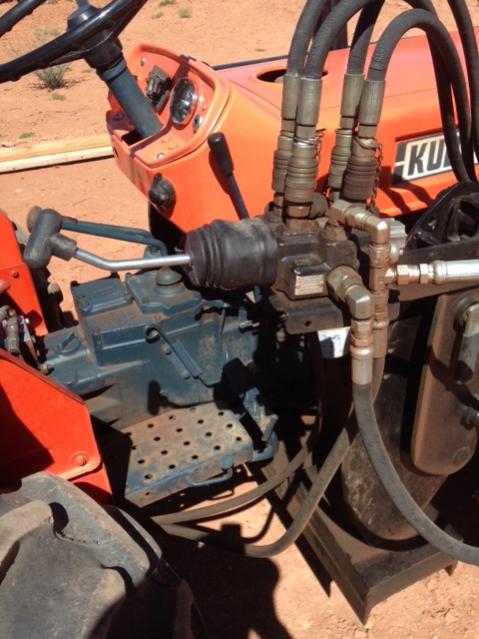

Here are some picts. of the existing hydraulic lines on my L245DT. I suspect the FEL control valve is not properly connected. It never has worked right. And when I used it to lift the empty bucket to full height it instantly cracked the pump when the cylinders fully extended.
I am trying to understand proper add-on hydraulics for this FEL, Kubota Knerd

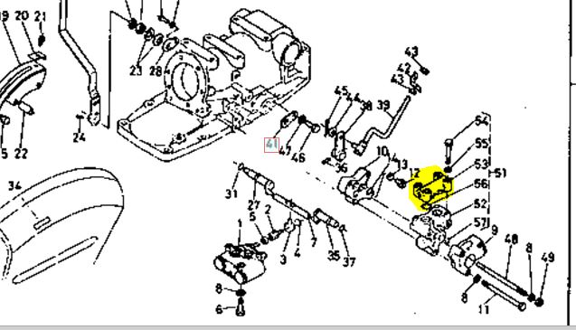

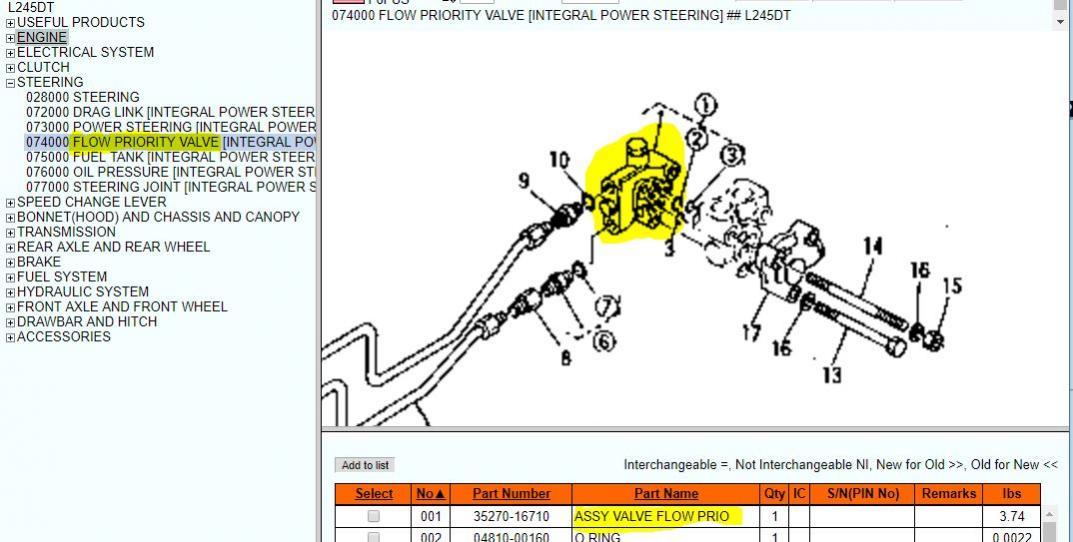

N.ID Wolfman.
Thank you for the reply. I see the priority valve (item 1 in the parts diagram) on left side under seat. This valve (in the diagram) is on this tractor, and it is sandwiched between the rear axle housing and the pressure relief valve. The diagram shows lines connected to the valve, however this tractor has no lines connected there.
Also shown in that same diagram is the steel high press. line from the hyd. pump. It is shown straight across the top of the rear axle housing (no rectangular block) connected to the housing near the top left. I suspect this line provides hyd. pressure to the 3ph cylinder. The 3ph works fine and causes no problems. It is the FEL that when the bucket is raised full up the hyd. press. instantly spikes and crakes the pump or the FEL CV before I can lower it.
In my last post to this thread there is a pict. #2147 of the FEL CV showing a hose from the back to the right side. I wish I knew how this CV should be connected. Thanks again, KK

So I take it you have no power steering?
Is there caps on the fittings on the priority valve?
And I can tell you what I think is wrong with the loader valve.
They have looped 2 lines together big No,No with Kubota systems.
They have either looped PB to tank, or PB to power, or power in to tank.
You also need to find out if they have installed (and it looks like they have) the closed center fitting into the side of the valve.

The rectangular block is just a tap, not a priority valve.
Nothing fancy about it, it just directs flow out and then back in to the system.
You do not want a closed center valve, that will blow the pump/ lines every time.
You must have an open center valve for it to work.
One line off the block (most likely right side of tractor) will be the power in to the FEL valve, then the left side fitting will be the return of fluid to the three point and pressure relief valve.
If the valve you get has In/ Power and OUT / Return and no PB (2 line valve) then you would hook the In line of the valve to the right side of the block and you would hook the return line to the left side of the block.
If it's a three line valve, In/Power, PB (power beyond), and tank/ return.
Then you would hook the In line of the valve to the right side of the block and you would hook the PB line to the left side of the block.
If it's not already equipped you will need to find a port, usually a plug in the side of the transmission or rear end housing to hook a hose to for the tank/return line.
Either set up will work just as well.
