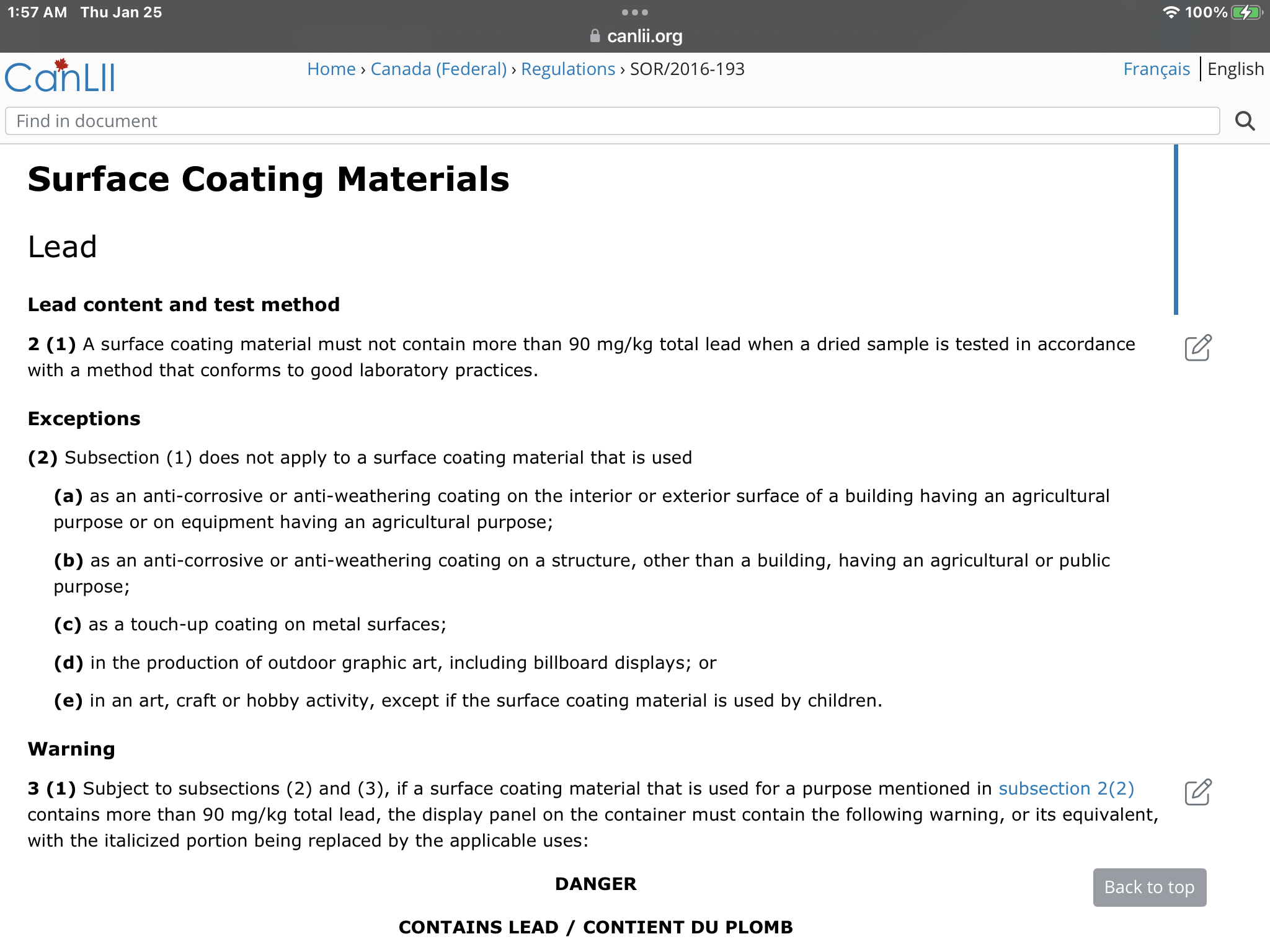

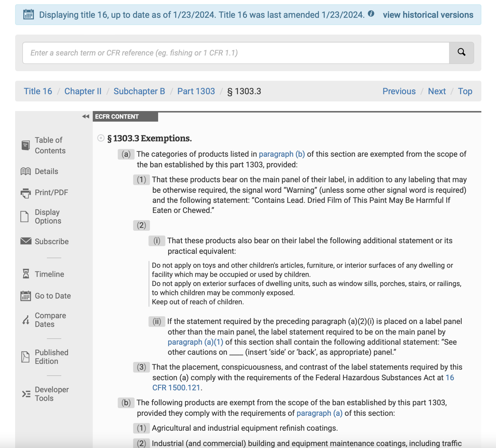

I pulled these from the respective Gov sites.
This appears to be the currently in force Canadian regulation and the exemptions have not changed and exclude paint for ag equipment among other exemptions. "current version; in force since Dec 31, 2022".
I believe the USA regulation is also current.
USA regulation

Canadian regulation
