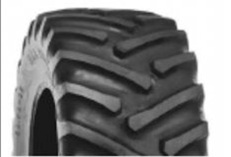

Option # 3: These are Ag front and flotation rear.
(I have the same series tractor as you, just a few sizes bigger, I have these tires and love them, excellent flotation and traction in all types of situations, including ice and snow without chains)
Front:
8.0 /75 - 15
rim 15"dia. 6.5"width
Rear:
13.50 - 16.1
rim 16.1 dia. 11"width
