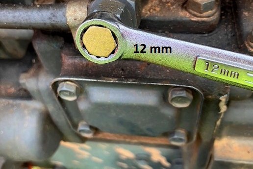

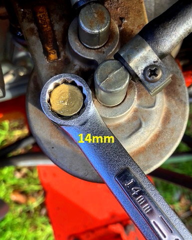

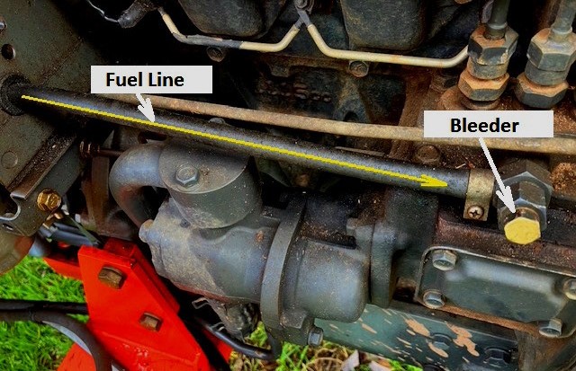

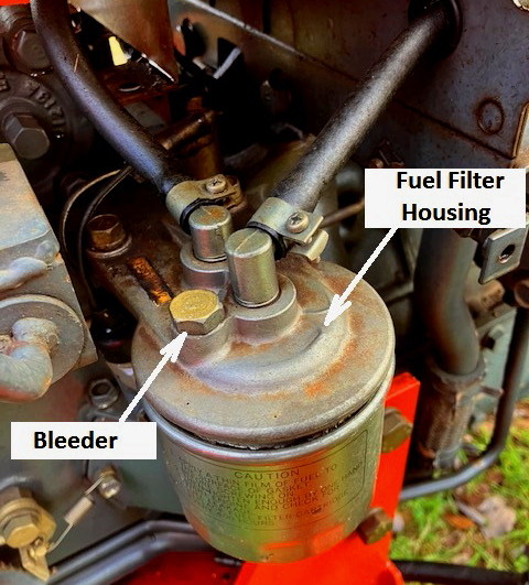

The bleeding process is all 'Gravity feed'.....so pretty simple on the L2350.
Replace fuel filter. Loosen the 'bleeder' at the fuel filter housing and let fuel flow until no bubbles/air is present....tighten.
Follow the fuel line to the Pump and do the same thing there (loosen bleeder and let fuel flow until no bubbles/air, then tighten).
With battery fully charged: Run glow plugs for a period of time (depending on how cold 15-45 seconds) and then crank engine. Give it a little time to push fuel up to the injectors.

Your pictures demonstrating the procedure are excellent.
Many who post pictures of a problem area of their machine post a close up (if a picture at all) and unless you're working on that model are not familiar enough to know what their showing. You have a distant picture showing the layout, then a close up of the actual process and wrench size deserve a "Best in Pictures" award !!!
