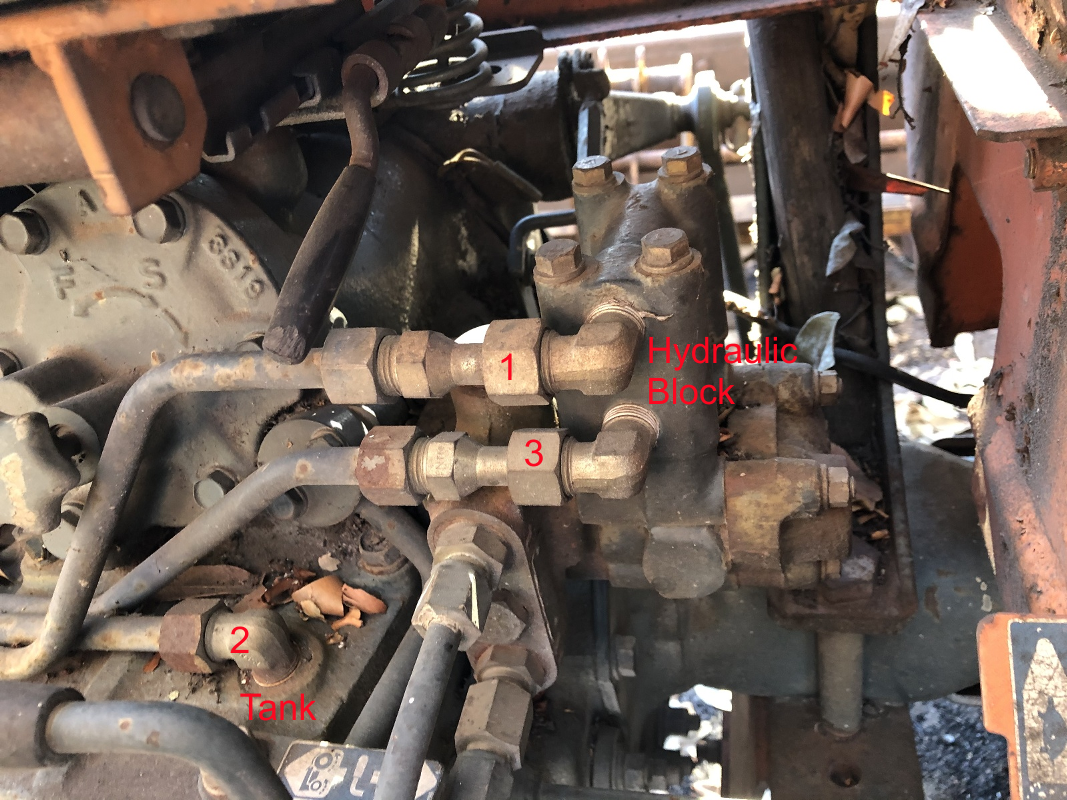

The link worked. How about a shot of the valve block?

Enough pictures for us to trace the hydraulic tubing to and from the block.

In the picture below, #2 is the Return line to the tank. I'm not sure which is which, but #1 and #3 are the Supply to the spool valves and the return from the Power Beyond port.
If there is a hypass valve on the hydraulic block that can connect 1 and 3 internally, all you have to do is operate that valve, however I don't see one in your pictures. So you need to connect 1 and 3 externally with a short piece of hose. before attempting to start the tractor.
Thanks for the pointers. I'll see if I can use one of the remaining hoses on the loader to do that...

Got the hydraulic plumbed as Torch described, tried jump starting the tractor with a good battery and nothing. Need to trace down the wiring next... Stuff near the bottom of the tractor is suspect. Bushings in the joints of the steering are gone, starting to look like much more of a project...
