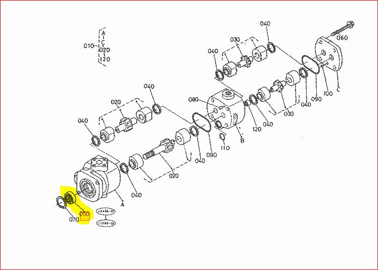

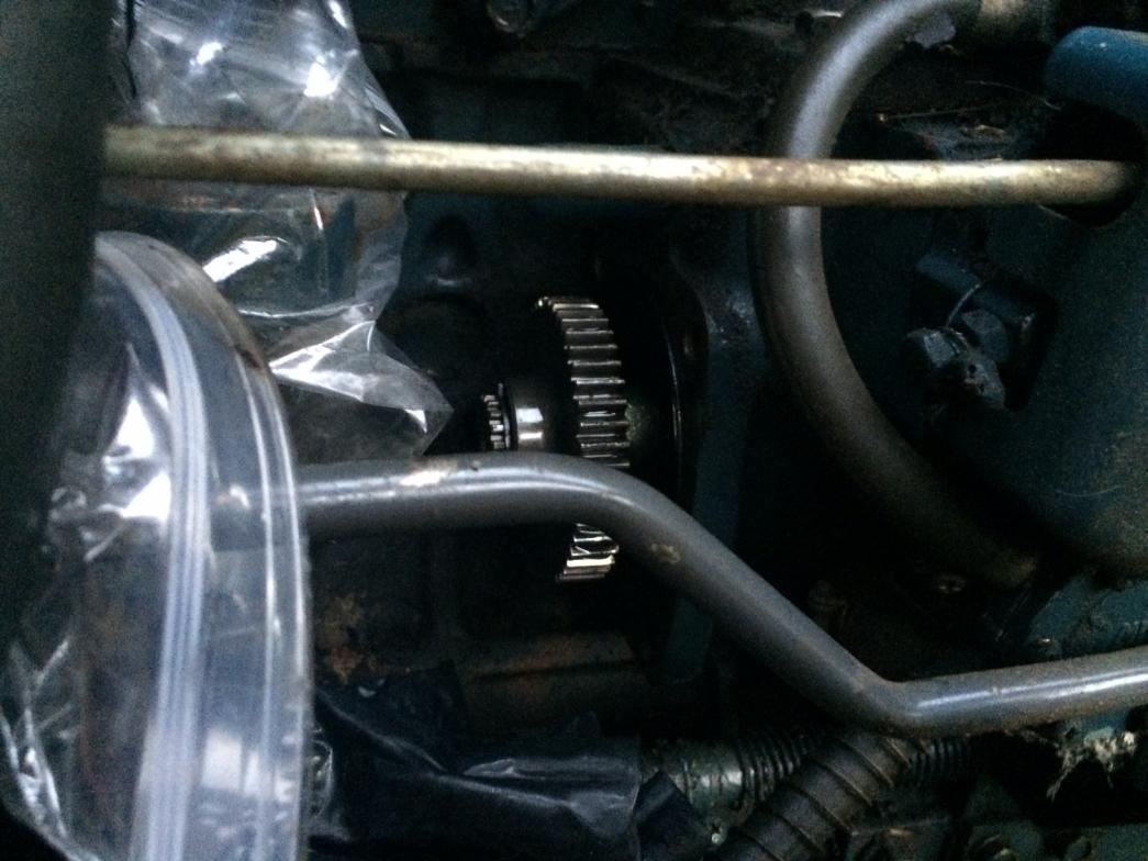

So,I have the hydraulic pump out of the tractor. I don't see any seals though. What I do see is a bearing, am I missing something? Could someone aide me in finding the seal on this?

Great! Yes, I did see that, it looked like it was part of the bearing! The part should be here today, so hopefully have it back together tonight!

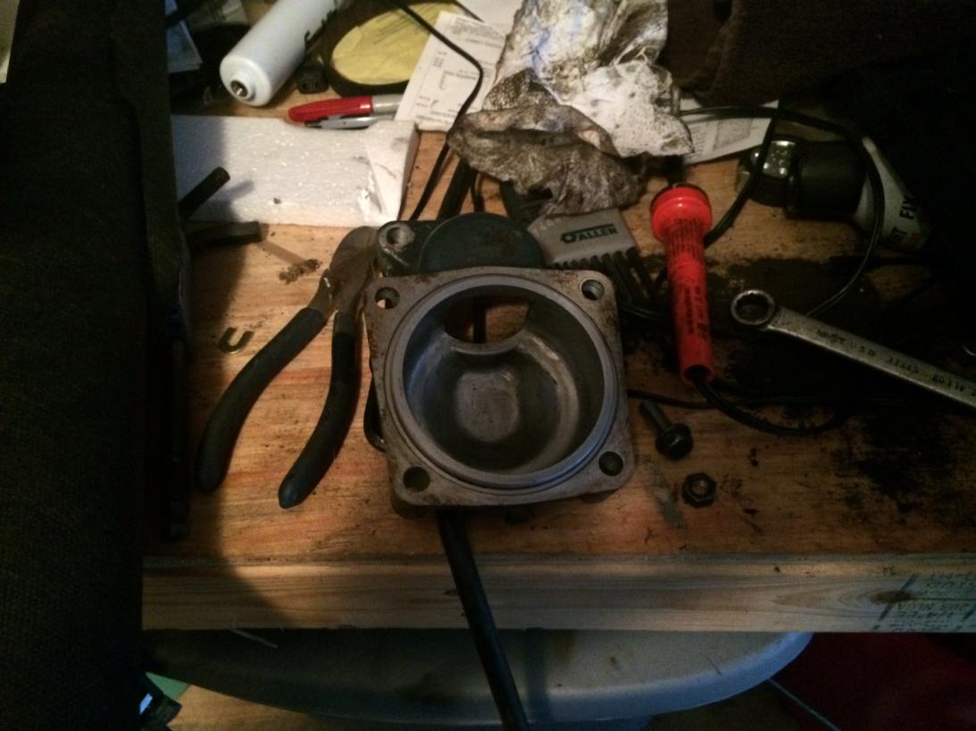

Sorry it took so long to close this out. I got the seal replaced last weekend, no play in the pump. A chunk of the seal was torn completely away. We will see if it holds, if not, I will get a new pump. Check out the pic! That was not tool damage!

In some scenarios, that seal is just a result of an internal pump failure, have seen things like that before. Case pressure climbs til seal fails. And if it filled crankcase that quick, then you want to keep an eye on it. My old clark forklift pump seal started seeping, but it took months to fill crankcase. Could be seal got really hot and just failed. Only one way to find out.
