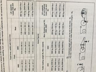

Looking at Impliment Limitations in the manual, page 11, seems I should be able to lift between 1400-1875lbs.
What could be causing the low lift capacity? Im wondering about the hydraulic pump he replaced - if its the right one?
