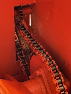

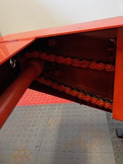

M mtnplower Member Equipment Kubota L5740 Jul 15, 2022 71 6 8 Sierra Nevadas Feb 29, 2024 #1 Does anybody have the drawing on how the roller chain gets routed for the l2195 snowblower?
M mtnplower Member Equipment Kubota L5740 Jul 15, 2022 71 6 8 Sierra Nevadas Feb 29, 2024 #2 The new chain is the same exact length as the old chain however there's several Links of Slack with the new chain clearly I'm not doing something correctly
North Idaho Wolfman Moderator Staff member Lifetime Member Equipment L3450DT-GST, Woods FEL, B7100 HSD, FEL, 60" SB, 743 Bobcat with V2203, and more Jun 9, 2013 28,726 5,134 113 Sandpoint, ID Feb 29, 2024 #3 I'm pretty sure it will be over the main drive gear (small) over the auger gear (large) and under the idler.
W wsurff New member Equipment L6060, Backhoe, Front Snow Blower, Grapple, Chipper, Box Blade Oct 8, 2021 22 18 3 NJ Mar 1, 2024 #4 North Idaho Wolfman said: I'm pretty sure it will be over the main drive gear (small) over the auger gear (large) and under the idler. Click to expand... I believe that is correct. Here are some shots from my L2195A which is probably similar. Attachments IMG_6091.JPG 15.2 KB Views: 33 IMG_6092.JPG 13.3 KB Views: 33
