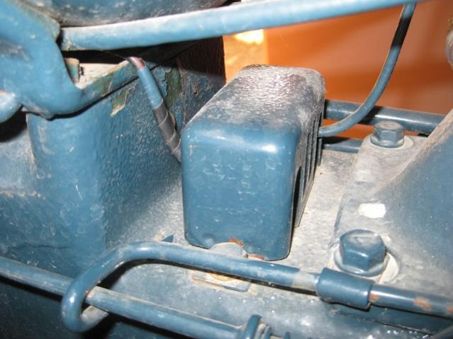

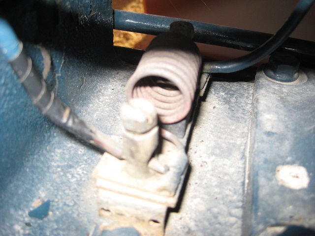

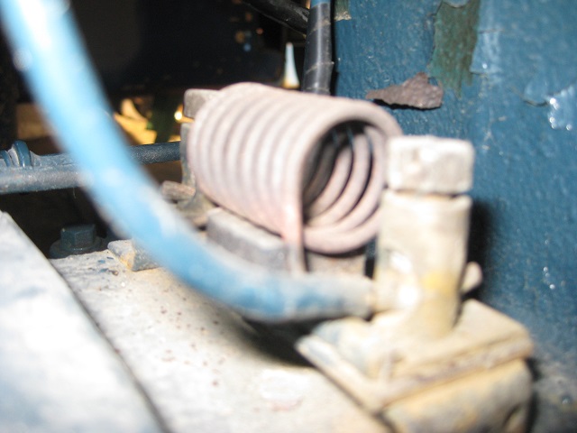

Birddog, is this the resistor you are referring too, or are you talking about the glow plug indicator on the dash that D2Cat mentioned above?
If this is what you are looking for it may well no longer be available. But it looks like it would fairly simple to make if you are just missing the coil. If you are missing the entire assembly then it would be a little harder to manufacture. A magnet does not stick to the coil so I am assuming it is copper. (But that may be a bad assumption.) To me it looks like a 10 or 12 gauge bare wire. To make one I would take the wire and wrap in 8 times around a 5/8" dowel rod then remove the dowel and bend a right angle on each end of the wire. Make sure the coils don't touch each other. Then install it in the holder. I hope this helps.
