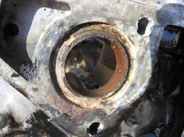

D2CAT ; Am forging ahead at the task, got the front gear case off just before dark. 3 smaller 'o' rings, and 1 big seal. The big seal from block to water flange/upper radiator hose APPEARS to have been leaking, rust and corrosion pretty apparent on the 'sealing ' surface of the seal and adjacent to it on the gear case.

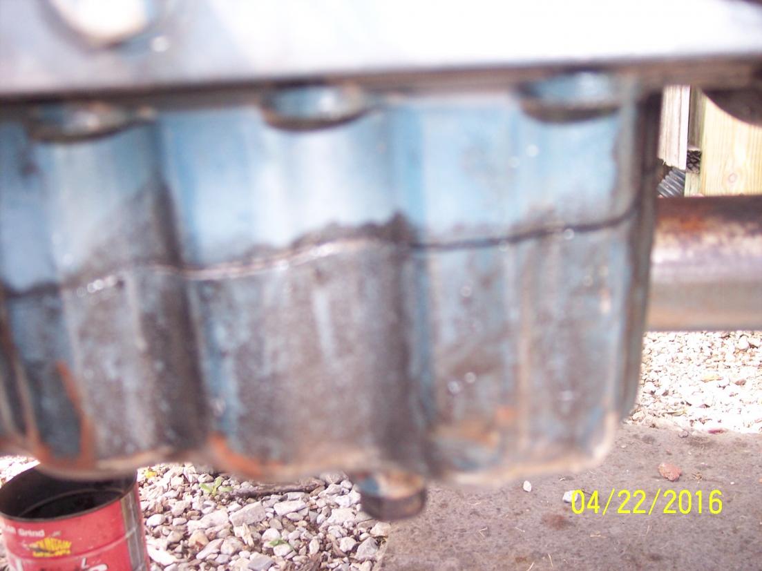

Yeah, the drain plugs bring up another 'gotcha'...one of them is stripped. Screws in, never tightens up. :mad::eek:
14,633
7,100
From what you describe I would not pull the pan. You indicate oil was OK, then you noticed water after a short run period. Fix the problem of water getting into the oil and go on.
The stripped drain plug...on this forum go up to the "search" and look for something like "stripped drain plug" and see what threads you dig up.
If the threads on your drain plug looks at all messed up, I'd buy a new one from a dealer and see how it threads in before any thing else. Be sure to get a copper washer for the plug.

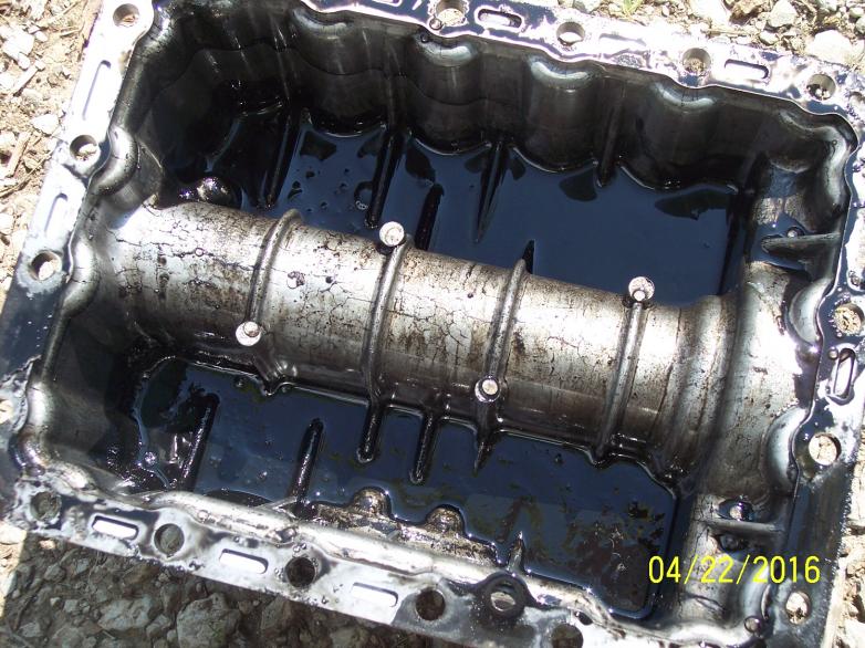

You have to figure a fix for the plug, 'cause a new pan cost $180 and it's a pain to get to it. Got to remove the front drive shaft. I've got an oil pan with good drain hole threads....... here's a picture of it.:D:D

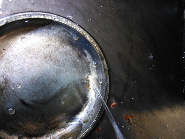

Maybe a new deal. As D2CAT mentioned, sometimes a hog gets a kernel..or something like that. I looked the front case over in the daylight, and realized that water really only passed thru it at the upper water flange area. I bolted the thermostat housing over the hole and poured it full. Imagine my surprise to see the freeze plug squirting water 6" out...and delight, might I add !!! The big rubber 'o' ring is also pretty shot. NO WATER running into crankcase..thank the Lord !!
Notice, also, the deformed 'o' rings sealing off the oil passages.

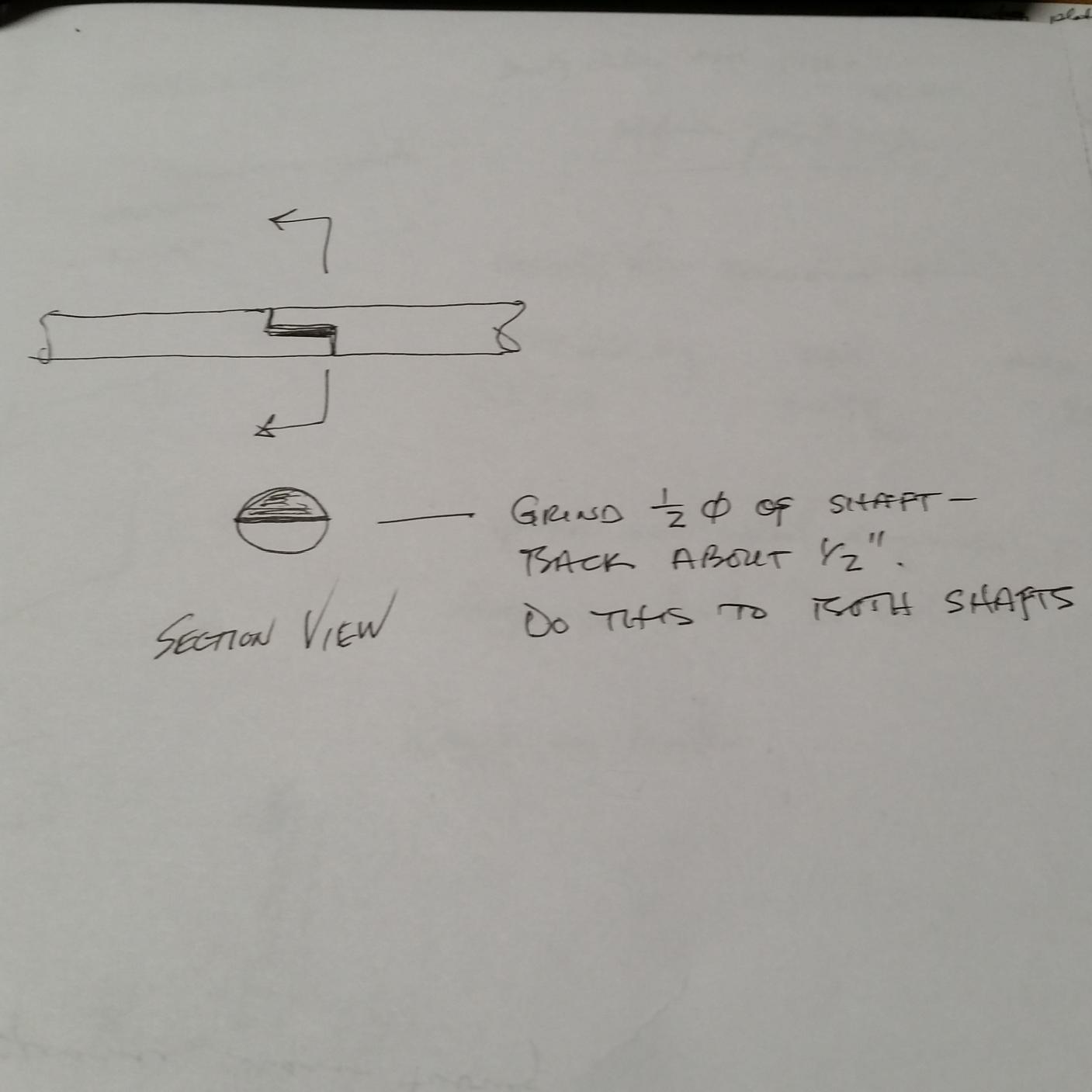

When you cut and modify your tie rod, use this method to have the steel back to full strength after the weld.
