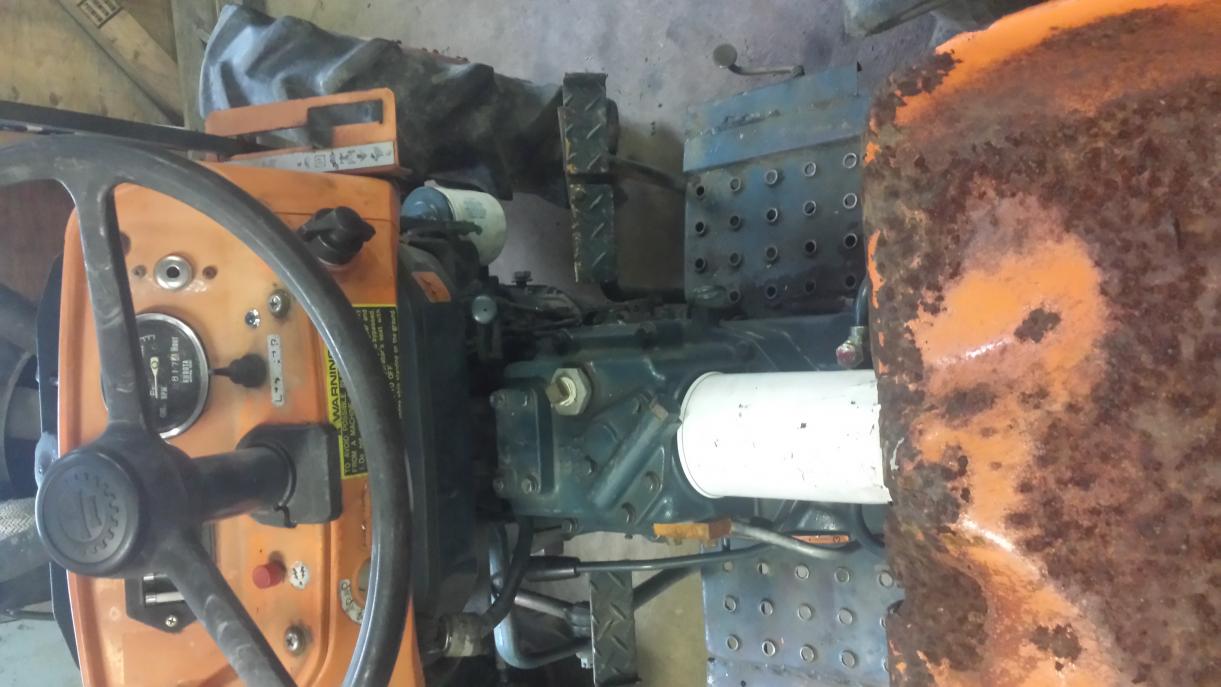

Hello im a new owner of what I think is a l185dt special I just got the tracktor running after getting the fuel pump rebuilt an injectors done it runs great small issue wont move pto is spining an cant seem to be able to shut it off theres a shifter on the right side by the steering wheel with two forward spots an two for reverse any one have any info on what might be the issue here. All l185dt tractors I have seen have shifts on the hump cheers

This machine have a selector for hi and lo range? Also one for two wheel and four wheel drive? Does it sound like anything turning? I suspect something is, as pto is rolling. Engine off- see if pto spins by hand. Some lever in neutral pisition maybe.

I don't see a gas pedal - it should be on the right deck somewhere. Since the lump on the hump has an oil filter, I wonder if this was an attempt at HSD? I believe there is linkage from the right hand shifter down to the side of the transmission. Does it also connect to the fuel system?
To the left of the filter, there appears to be a hydraulic block and tubing section. Mine had a block/port just to the left of the driver's seat. Does yours?

Thrre is a gas peddle on the right floor board an when yiu say attempt at hsd what might that in tail I was under the impression that hsd was not out when these tractors were built an if thats the case does any one have any info as for the leavers I have pushed pulled an tried out all of them still nothing when I get home tonight all try spinning the pto with the motor off thanks everyone so for for the help im not really looking forward to having to split the tractor haha also I will take a few better photos tonight cheers everyone

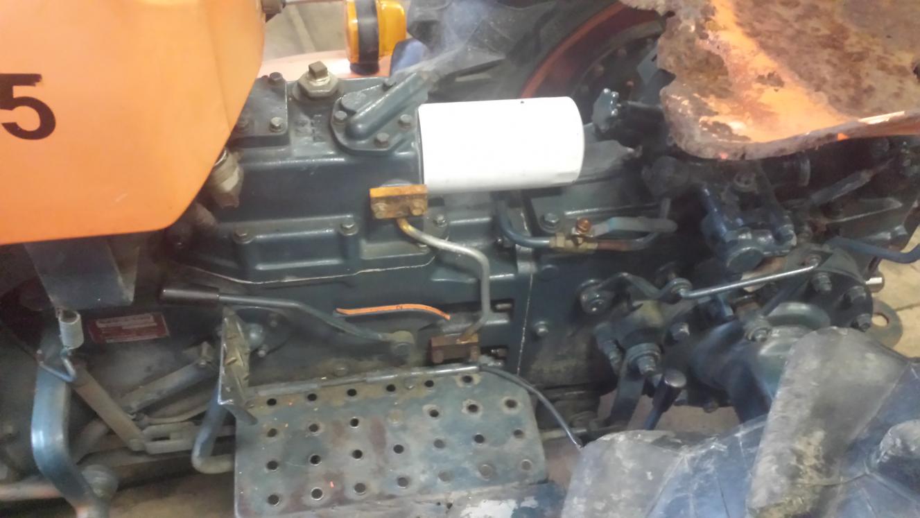

The only thing i've ever seen that closely resembles that transmission was on an old ford tractor my grandfather had. It looks like a version of the ford select o'matic transmission. If i remember right, forward/reverse and the speeds were controlled by a cable, and were very finicky about the cables sticking. They didn't sell many due to most people preferring gears. Judging by the pictures it looks like kubota must have experimented with a similar style transmission for a bit. And you came across one hell of a rare find :)
9,066
4,539
I just realized i should have stated how the transmission worked. The transmission was basically an automatic like in a car. Clutch was used to shift between forward, nuetral, and reverse. And to engage pto. Once moving you could bump the lever up a notch and it would shift to the next gear. Much like shifting between 1,2 and drive in a car.

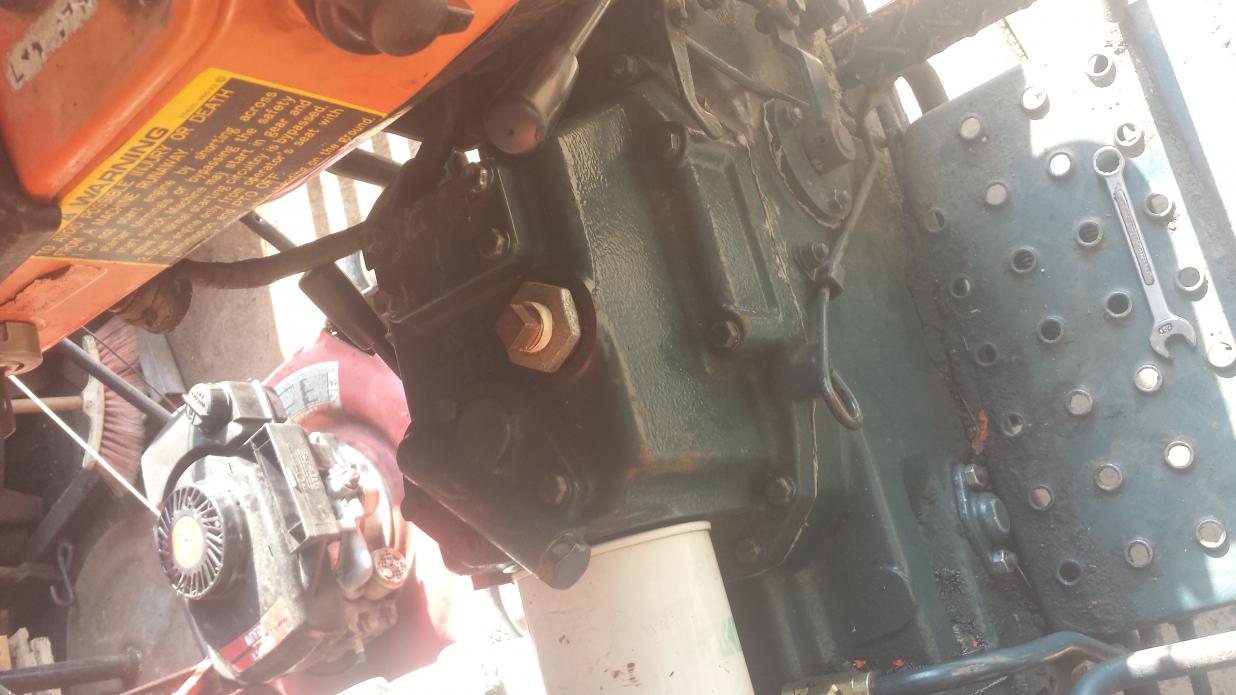

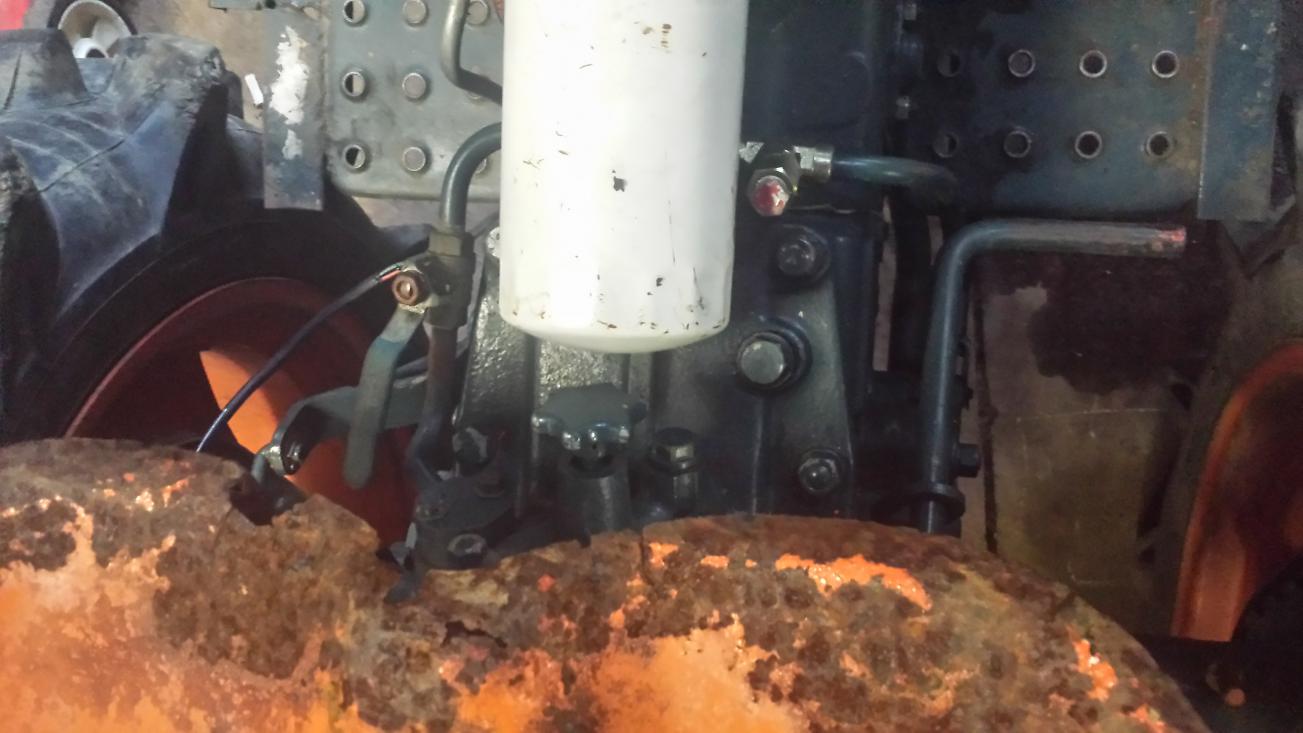

I was leaning towards a creeper gear unit, that was used for trenching or slow tilling, but the shifter attachment throws that all out of wack.
It does not have the same case as the standard shift model (added right side round plate that the had shifter goes too.) so it wasn't just bolt on unit per say. It still might be a purpose built gear reduction unit or creeper unit.
The other (and more likely option) like gpreuss suggested is a HST proto type or add on.
From the pic's someone has been into it recently as the cover for the unit and the shifter (round plate) Have new gasket sealing material around it.
Also looks like someone has bypass/plugged the hydraulic porting with after market pipe plug in the top of the unit.
If moving all the levers is doing nothing then I would suspect that you might have an internal problem.
It should have had a pipe or hose feeding hydraulic fluid to the port that they capped and that might also be the reason the unit is not working.
More pictures might help?
Does it have a regular 3 point setup on the back?
