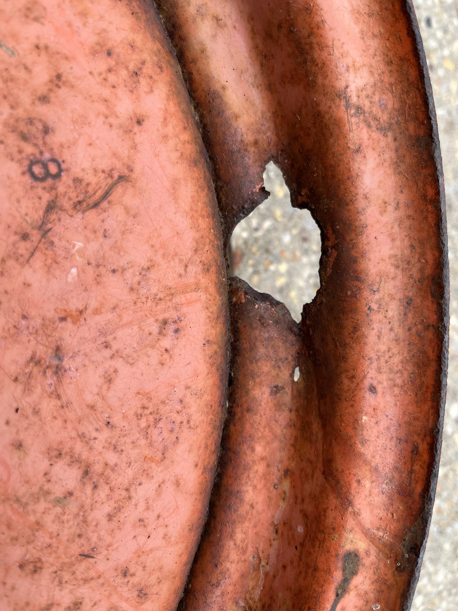

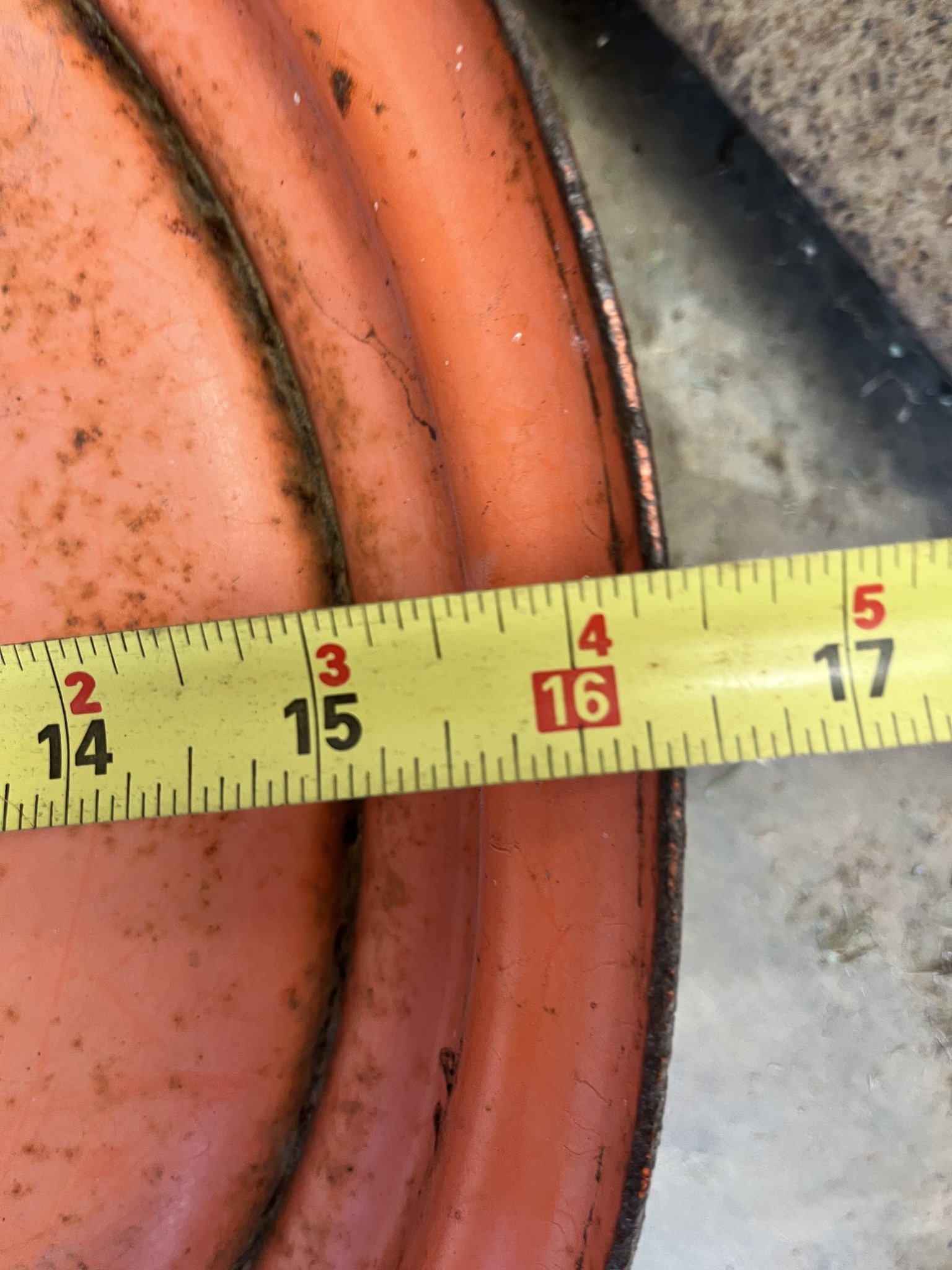

Anyone know where I can find a front rim to fit a Kubota L185 tractor?
I pulled rim off to replace front tire and noticed the rim was just rusted through.
I have attached a few pictures with the measurements.
I don’t mind buying a usedrim if I can find one.

You will probably never find a set but you need to get the correct size if your L185 is 4 wheel drive. 2WD is not that important to be the same size.

Show pictures of the rusted through area. It can probably be repaired quite easily based on what these pictures show!
12,118
3,445
That's not a problem. It can be built up and use a flat washer to weld where the valve stem goes and have a nice smooth opening. A 4" grinder with a flap disc can solve your problem. Surely you have a friend or neighbor who can weld?

that is reassuring! My brother in law can weld so I will take it to him and we can make it happen! Thanks for the advice! I will send pics once we get it fixed up.

here is the bad area. It just so happens to be where the tube nipple comes through.
My old Ford 9N had rims like that…. I fixed them with JB-Weld… They lasted another 20 years before I sold it.
Used duct-tape as a “backer”…filled the hole with generous amount of JBWeld…then used a grinder to bring it down to dimension…and drilled a hole thru the JBWeld for the valve-stem.
As I said…lasted 20 years just fine. (It was a tube-tire..not tubeless.)
7,766
3,077
gee, that's an EASY rim to fix compared to 1/2 the rears I've owned......
best to have entire rim sandblasted, then cutout and patch the bad areas, epoxy primeer paint both INSIDE and outside, then paint in Kubota orange.
