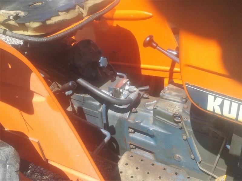

I would be really glad if I had such a plate, unfortunately it is not the case... (picture).
I think the best option for me is to add an intermediary plate between the power line and the tractor connection, either at the pump exit or at the end of the line near the 3pt input.
If there is no factory outlet block in the line just cut a section out of the tube and put a couple tube fittings on the ends. Quick, easy and inexpensive. I have done that on dozens of old Fords.

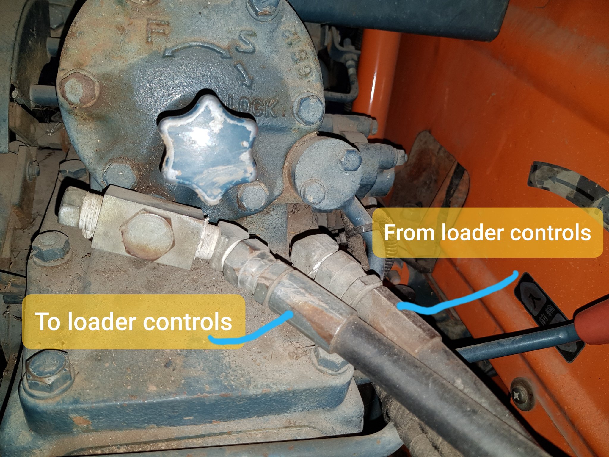

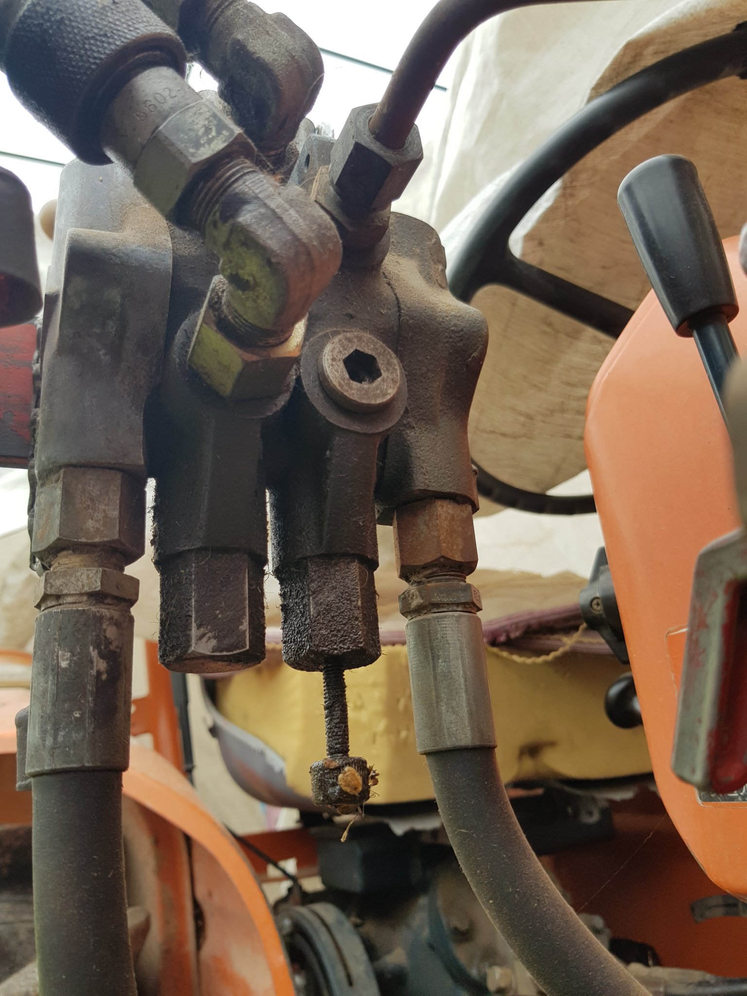

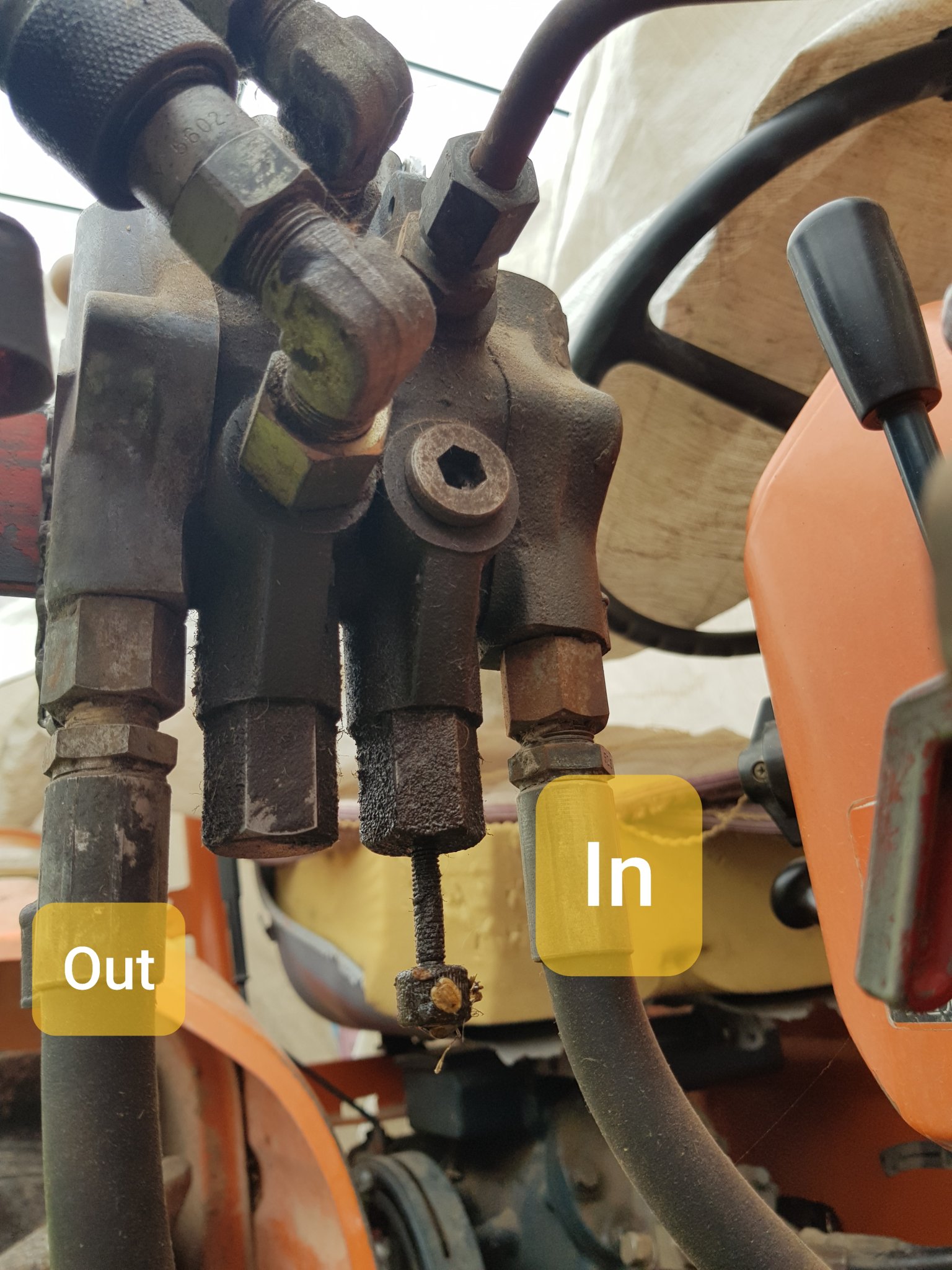

I see multiple problems with that plumbing - use of tank return for power beyond AND a dead headed DA work circuit. The deadheading is probably the most concerning.
It is not connected as a power beyond system, the return hose goes directly back to the transmission case.
Yann
L1801DT (Zen Noh), 1991 Gaz 66, Mitsubishi Delica 4*4, Ford Focus, 3 Ouaz 4*4
Dec 17, 2019
22
Kirghizstan, Rot-Front village
After thinking about it I am actually not sure about that, is the out connection on the picture connected to a power place or this just flows back to the transmission case?
There is obviously an error somewhere as I can control the 3pt with the loader controls...
12,820
7,284
The exact relationship of loader and 3pt is not clear to me but replumbing will make it clear.
It would be interesting to see the underside of that round flange on the end of the hydraulic supply tube.

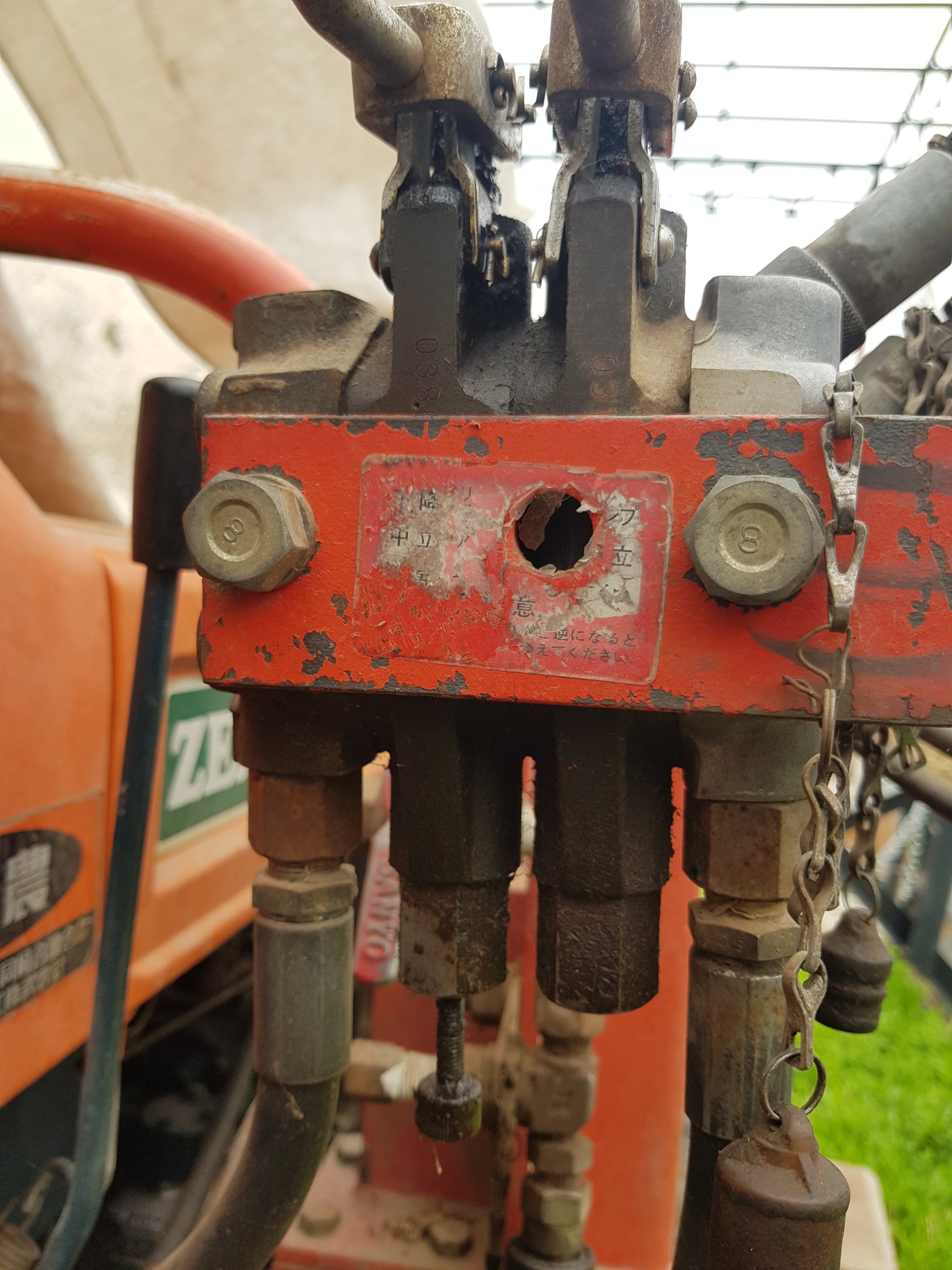

You're right. Your tractor is missing a whole section of gearbox that is visible in the other pic (probably another gear splitter hi/lo type of thing) and your 3pt pressure feed line has no hydraulic 'block' there.
The good news is i don't think your loader valve NEEDS a separate 'power beyond' port to be put in series with your 3pt, because it is a 'sectional' valve for which power beyond would probably split off at the 'outlet' housing, meaning all the passages of everything in between were designed to withstand high pressure. In fact, it seems likely your inlet and outlet sections on that valve are identical other than having their ports drilled in from opposite ends. So that entire valve assembly can handle high pressure. Therefore you can just power your 3pt from the outlet of your loader valve, and while using the 3pt your loader valve will have pressure on both its inlets and outlets and will not work until you release the 3pt handle, but it won't blow up either. The issue with that approach is that you would still need the pressure relief valve between the pump and loader valve since the loader valve does not have its own pressure relief.
It does seem odd to me as well that you have a dual-acting valve with only one work port connected to anything and the other blocked, but this may make sense if your loader lift cylinders are single acting and do not have 'power down', or in other words only drop by gravity. A picture of the entire loader would help. Regarding the comment about 'deadheading' with that blocked port, im assuming the long screw coming out of the bottom of that valve section is and adjustable stopper that (if set correctly) would prevent you from moving the spool to the position that would deadhead the pump against the blocked port.
If you are willing to do compression fittings on your pressure feed line, you could install fittings into the pressure line in the same area that the hydraulic block exists on the other tractor, and your existing hoses may even reach there and not need to be swapped out for different hoses. You could potentially even package the pressure relief valve into this area somehow. Replacing the loader valve with one with an internal pressure relief is still an option.
If you are not willing to do compression fittings on your pressure feed line, then a 'fitting block' between the pump outlet and the pressure line would probably be the next easiest.
