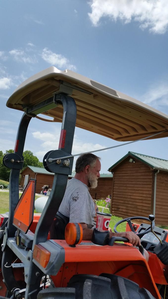

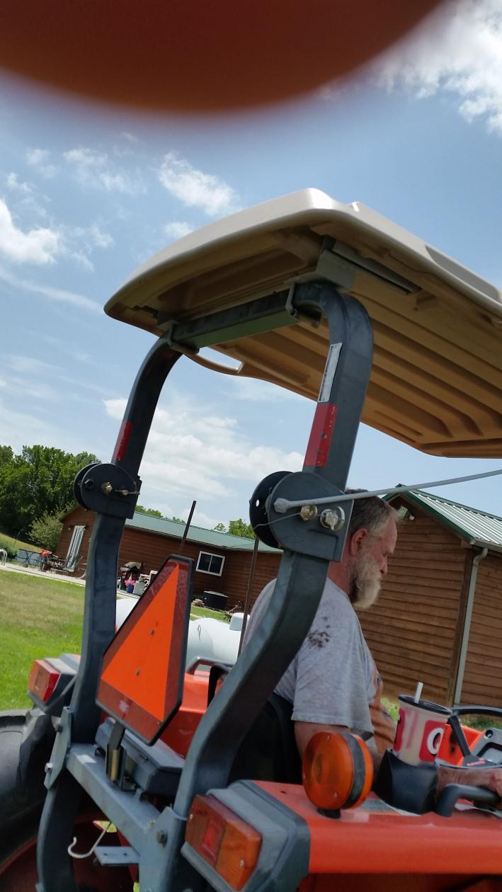

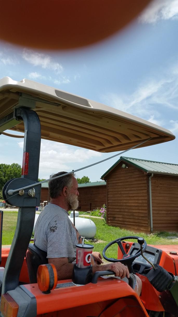

To give you some ideas, here's a canopy I built for my neighbor so his wife wouldn't have to set in the sun while raking hay. It looks as good as factory, if you ask me, and I got the top at the local golf cart shop for $25. He had a whole dumpster size box full of them, so I'd guess other shops have the same. It's a light brown color and matches his Kubota nicely.
Used unistrut pieces, bolts, washers, and a rod to come down on the off side for a brace. Made the clamps from threaded rod. Did not drill any hole in the canopy or the ROPS...used all existing holes. Probably took a couple of hours fabricating it, but had to get some measurements off his tractor also.
