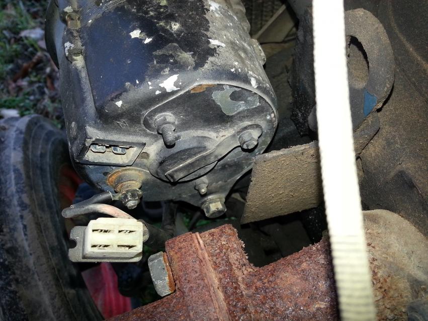

Post a picture of the back of the alternator if you would, because all the pictures that I find for that alternator has a 3 pin plug???

Here is a picture of the alternator. There are no identifying numbers on it.
I have seen 15221-64012 on Amazon and other web sites as the correct alternator for this tractor but again it has three pins.

Looks just like the alternator on my L 1500, mine also has the same four pin plug,
however the wiring harness only uses three of those pins.
If I remember correctly as you look at your picture the lower left is not used on mine.
Sorry but my tractor is tore apart right now so I cannot confirm.
Having said that and with the proper schematic diagram of a three pin alternator
you should be able to use it, you will just have to obviously change the plug.
