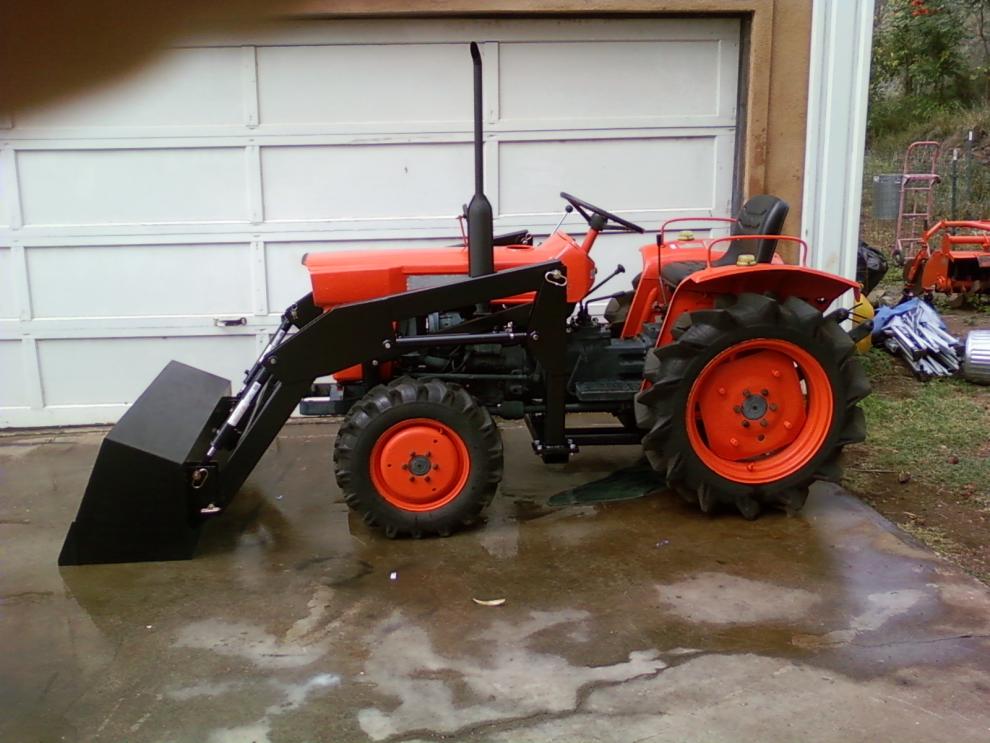

l1500dt loader hydrualics
david f
Nov 30, 2009
9
Kihei, Hawaii
Hey everyone. finally got the loader on. Was hoping someone could tell me what pressure I should set the reilf valve on the loader control at? What psi can the pump put out? I tried out the loader with the pressure set @ 2000 hope this was not to high. I read some where on this site that too high of pressure could blow a seal in hydraulic pump, or was it between pump and housing?(l1500dt):confused:
I remember reading that the L1500 was the equivalent of the L175.
Here is a link I found that says the L175 Hydro pressure is 1700psi.
Hope this helps. Other guys that have been doing pressure checks will probably jump in soon.
Good luck,
Scott
