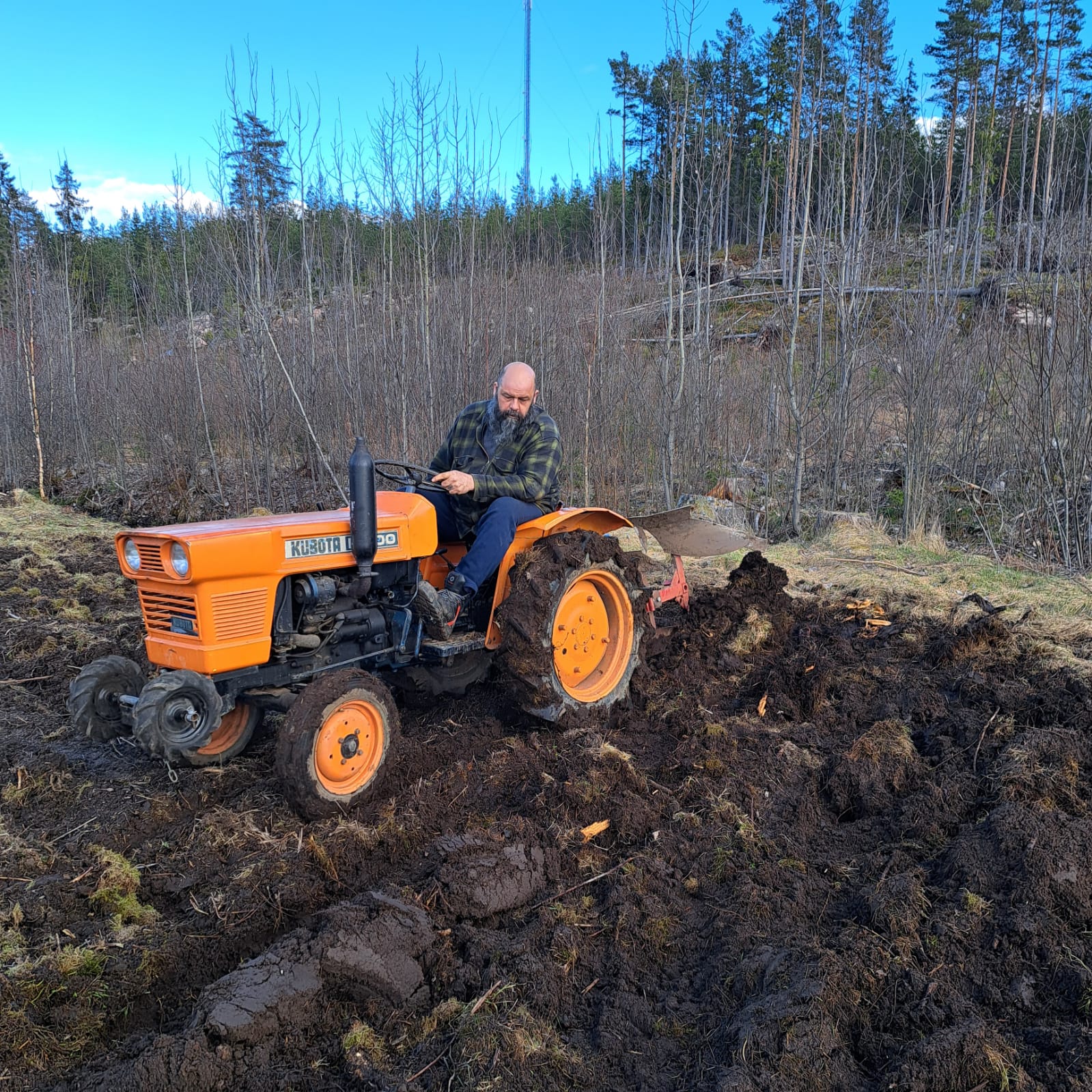

Hej everybody, new here on the site and introducing my L1500 from as i know somewhere end 60. Got this tractor about 10 years ago and use it on my little farm. It is a wonderful little tractor, and use it for everything. When necessary i build my own equipment. I saw that it was possible to have a little digger on the back. And i was wondering if there was something original for a frontloader. There is no hydraulic on the machine, but the solution for that is a electric pump.

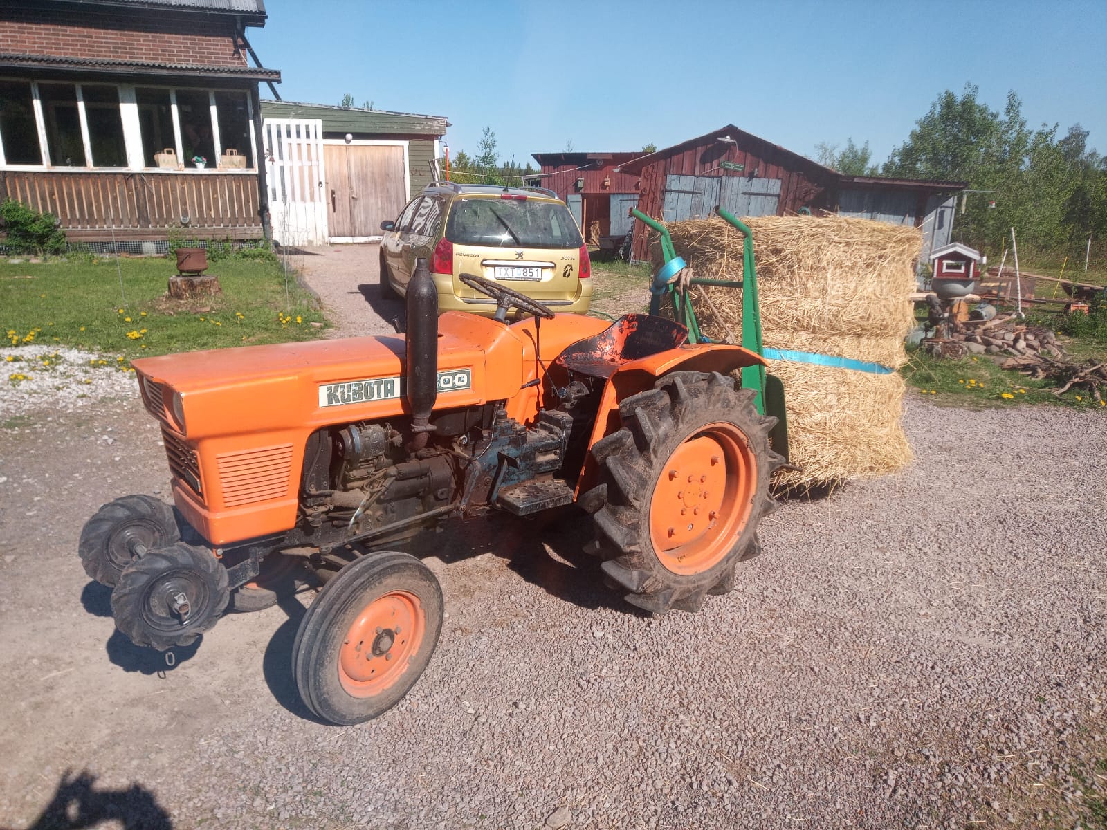

The wheels in the front do i use to push hay balls. The ones on the photo are around 220 kilo, but you have them from 500 kilo also, roll them on the round side and then I can push them with the tractor.

The use of the small wheels to push bales is a great idea!
