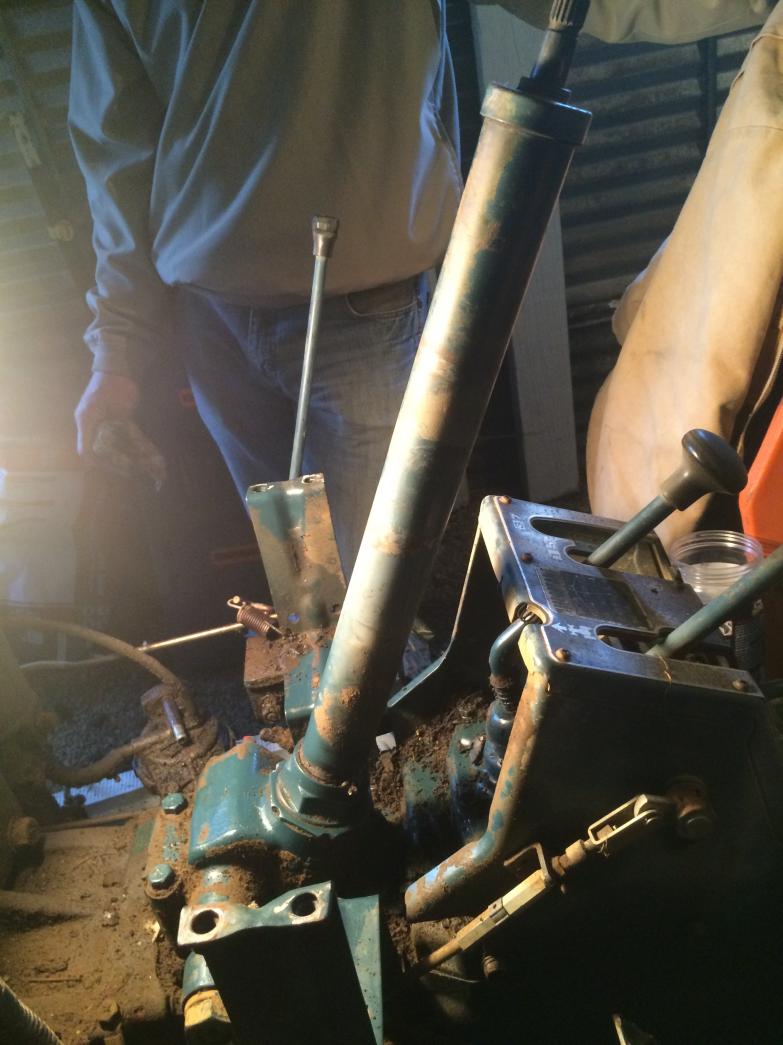

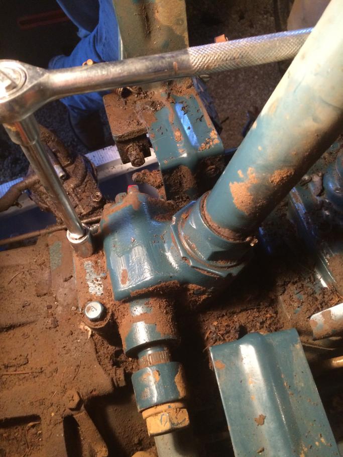

sgriff
L235
Jun 16, 2015
green cove springs florida
Re: sgriff-L series steering boxes replacement
I called Kubota and was told that the original steering box is no longer available. They had a replacement but it also has been discontinued also. It actually started with the shaft in mine broke, that was discontinued so that's when I decided to replace the entire box. It is a 2WD with manual steering. But I have drawn a big fat zero on finding even a used one. I'll keep looking, it is a little work horse for a tractor. Thanks again for all of the input it is great to be able to lean on some one else's knowledge out there.

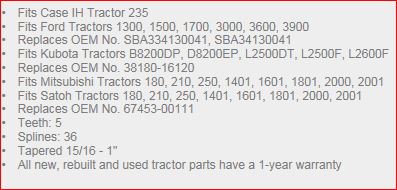

Not sure if this pertains to the conversation as I am unclear what you really need to replace with your steering but if you need the steering shaft I replaced one on my uncles B8200 with this shaft from Kumar Bros USA http://www.ebay.com/itm/191477858614?_trksid=p2060353.m2749.l2649&ssPageName=STRK:MEBIDX:IT
So far it is working fine and had no problems with it. They sell other hard to find parts and are making discontinued parts as well from what I understand.
