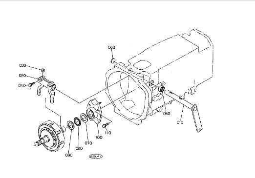

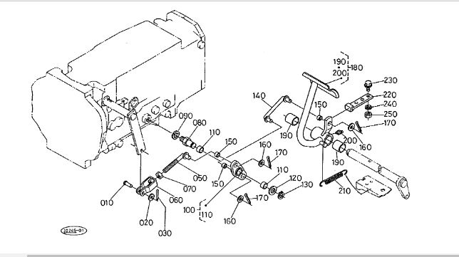

That model has a mechanically engaged and disengaged wet clutch pack.
Check that the lever (10) on the side moves with the pedal, and that the center shaft rotates ( I've seen them break at the weld).
If it all does move then the problem is internal and will need to be split to find what's going on inside.
By the description of the problem sounds like a linkage or fork failure.

Check the linkage completely, as it's very complicated on that model.

Following up on Wolfman's input, thank you Wolfman, exposed everything external and the lever moves and center shaft rotates. Adjusted clutch play to see if that made a difference. No surprise, it didn't, but was the only other external thing I could think to try. Unfortunately, I agree, linkage or fork failure is most likely culprit.

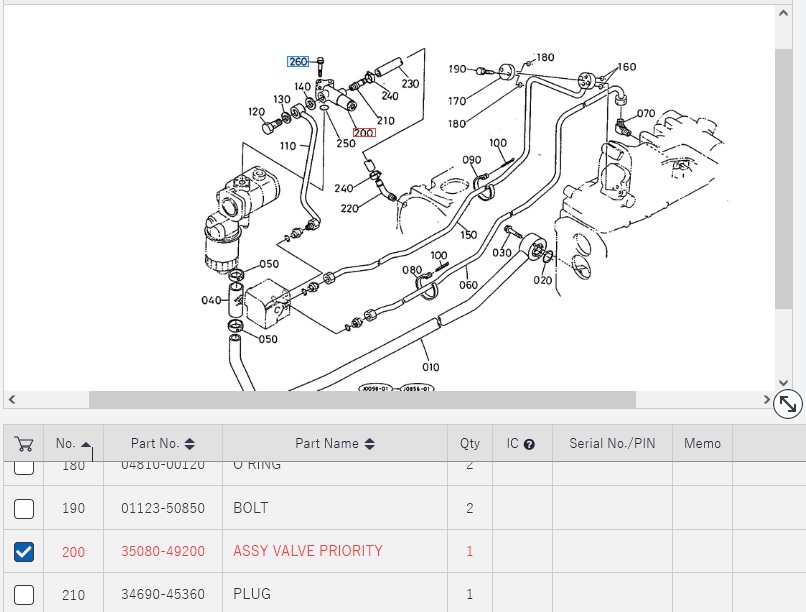

Guessing here, but the parts diagram shows a priority valve 200 on top of the main hydraulic pump that sends pressurized oil to a port on the trans - not sure what then directs it to the clutch pack but if there's restricted or no flow from the priority valve, there might be no clutch action. Its not unheard of for a plugged priority valve to stop the show.
Its something you can check without splitting the machine. Unbolt the priority valve and see if you can clean/disassemble check for debris, check for binding etc. If you find skudge in there, the machine may just be way overdue for hydraulic fluid and filter change. Best luck - Dick B.

Well I'm told that the clutch in the L3650 WET is fed oil from the priority valve, but only for cooling, not for disengaging it. Unlike most Kubota wet clutches, there is no control valve. (That fact is borne out by the parts diagrams for the model). To make matters worse, Kubota appears to have abandoned the model - dealers can't order manuals or parts.
The clutch pack has heavy internal spring discs that keep it engaged for driving. That function is apparently working ok. The parts inside that disengage it are the problem. If you aren't in a position to work on it yourself a local independent ag repair shop may be the only answer. If you were closer - or knew a trucker who would drop it off in MA I'd tackle it myself out of sympathy for this orphan. Again, sorry I'm not more help. Dick B.
