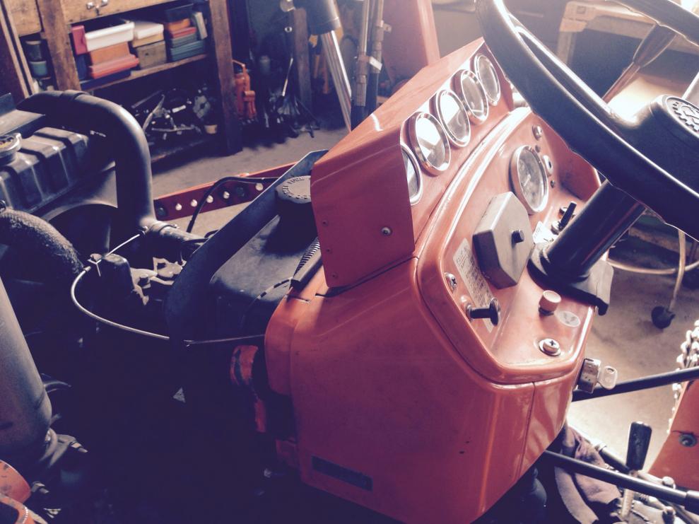

Am meter
Electric temperature sensor gauge
Mechanical temperature sensor gauge
Mechanical oil pressure gauge
Electric volt meter
wow, look that dash, nice information for everything.
can you plz tell tme what the diference at the readings of the temp gauges, the one at the head and the other at the flange.

I can't take any credit for the gauges or the other 6 upgrades, I owe it all to my great neighbor. Here's a side picture of the new dash.
Most of the gauges were sourced at Princess Auto. They are all generic parts. Do a search on Google and you will find everything you need.
I haven't run the tractor since the install of the mechanical temp gauge.
The electrical temp gauge showed me running VERY hot.
Will let you know the readings when able.

Do you mean that your 'great neighbor' (what a wonderful neighbor!) did the fab on the gauge dashboard? That is some very nice sheet metal work!
He gave me 4 of the 5 gauges, installed them, built the gauge holders.
That plus roughly 8 more upgrades.
Will put it all in a new thread.
