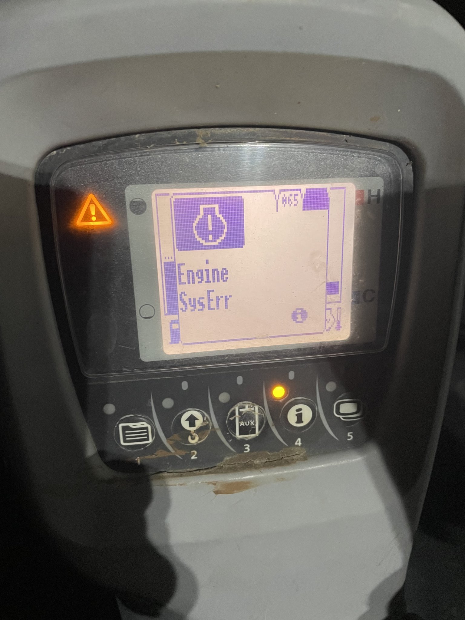

There's 3 sensors ! One unmarked, one gray, one black. So, question, which one was replaced and was it the proper sensor ? If it was the 'gray' one, did you SEE the gray marking on it ?
If you just 'bought and installed', it's possible it's not the correct sensor for that location.
Obviously those 3 sensors don't have the same charcteristics(temp range, slope,DVDT,etc. but probably will fit in any hole.
Those are exhaust temperature sensors. Their only differences are the cable's length and the connectors' color.
They do not require reprogramming the system, they are plug-and-play.
Diagmaster needs to be connected to diagnose the concern.

I talked to the dealership and they don't think I have a fuel pressure issue, but I installed some clear tube and found air coming from the bypass line (see pic). I replaced all the rubber hoses and checked the check valves in this area. I was still getting air, so I just plugged the return line connection to the fuel supply. This basically just a recirculation line anyway. Now that air is goin to the tank return line. This should have the fuel issue fixed for now.
I guess I will need to take it back to the dealership and get the sensor error code reset for the sensor I replaced. Hopefully that will fix the regen issue and get me back in business.

I took it to a different dealership to get the codes reset. Diagnostics lead to an ECU failure as the issue. Yes, a pricey fix. I’m supposed to pick it up toward the end of the week.
