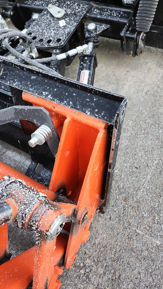

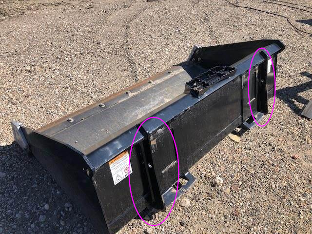

Kubota tractor buckets are NOT interchangeable with a Kubota skid loader! You can attach them but the side bar is 2” thicker on the side of the quick attach bucket on a tractor then a skid loader bucket! So when you attach the bucket to a skid loader and curl the bucket (empty or full) the edge rolls back onto the lift arms and forces the bottom of the bucket to split the slots out! You can go from skid loader to tractor with a bucket but you can not go from a tractor bucket to a skid loader. I got this from the dealer who said he split two out before they knew. On the attached pictures you can seen the vertical bar that is scratched from rubbing on the skid steer loader arms and forcing the bucket to split out!
First off, are the photos of a bucket at the dealership or your bucket? It sounds like you're posting information provided by the dealership. Second, is there a less than obvious reason why Kubota uses wider flanges on the tractor bucket compared to the skid steer bucket? Does Kubota not want tractor buckets going on skid steers? You state that it's to make customers buy two buckets but could there be another explanation?
Also, what is the situation with other companies that make tractors and skid steers? Are their buckets interchangeable. Regardless, this seems like an easy fix if you have a cut-off wheel, plasma or oxyacetylene.
My bucket, but the dealer after questioning him admitted to doing it to two buckets also. Yes simple fix and that is what I am going to do but I should not have to, quick attach should be universal
I took a look at my two buckets that came with the MX6000 and M6060 and they both have the wide flanges. None of my other FEL implements have those wide flanges i.e. pallet forks, grapple, rock bucket, snow plow, auger or boom pole. I imagine that Kubota wanted to make it easier for their customer base to get the bucket back on the loader so added wide flanges to help guide the bucket into place. Perhaps they never even considered backwards compatibility to their skid steers.
If you go to Kubutousa.com and price a 72" heavy duty bucket for your L3560 it's $1,347. If you price a 74" heavy duty bucket for an SVL65 they range from $2,347 to $2,604. That price difference is most likely due to the difference in the amount of steel used (hence weight). Maybe some engineer or project manager reasoned that for those with a tractor and a skid steer, they would most likely have a bucket for each with no need to interchange them. Who knows, but I doubt it was done as a way to force owners to buy more buckets.
I think your terminology is confusing some people. Rather than saying 2" thicker, you mean the side flanges are 2" deeper on a tractor bucket compared to a skid steer bucket.

I took a couple of photos this morning of the snow blade on the MX6000 and the EA grapple on the M6060, and it's obvious from the photos that there's nothing on the outside of the FEL to interfere with the flanges on the Kubota tractor buckets. The SSV shown has an entirely different configuration and it's clear to see that the flanges would make contact with the loader arms which sit way outside the SSQA plate.

@Farmer1057, it sucks that you have to modify the tractor bucket to use on the SSV, but you'll get a couple of nice pieces of flat bar out of it. :D I'll never own a skid steer so it's not likely I'll need to modify a bucket, but at least it's an easy fix. Maybe send Kubota corporate an email and let them know what you found.
White cross-hatched area indicates the steel to be removed for anyone still confused.
