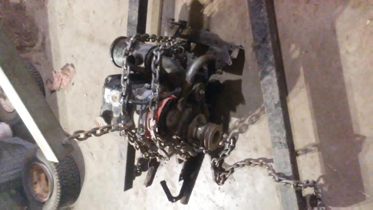

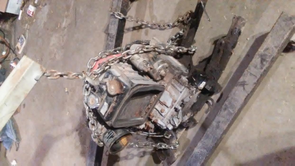

Picked this little guy up at my local scrap yard for $20. Can anyone help me figure the fuel system out on this motor? It trys to start if I mist it with starting fluid, but I can't get it to kick otherwise.
I attempted to bleed the injectors, and one spurts good, while the other kind of sweats. It's possible fuel just hasn't gotten to it yet. I would think it would still try to start on that one cyl though.
There was a little water in the fuel system as well, but it was mixed in with diesel.
Any tips or info/manuals, would be greatly apreciated. I don't want to have to replace the pump.

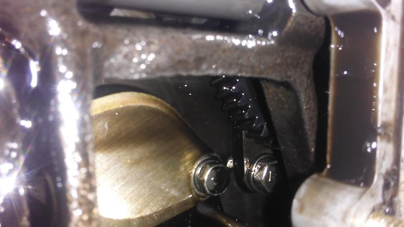

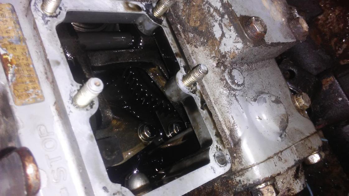

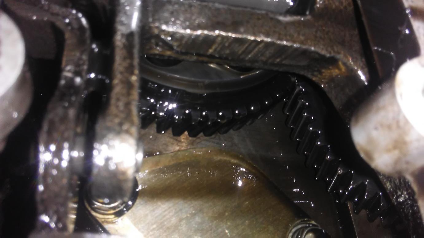

Well........it has perfect compression. The fuel system is primed, and the glow plugs work.....after a few minutes of cranking, the
Dam thing fired right up. Then up. Then up.......I flipped the kill switch and it wouldn't shut down. I wielded my trusty shop rag and suffocated it. I live in fear for what I have created.
Paradox1559
Apr 12, 2018
Defiance, ohio, USA
Where might I find an exploded view? Or are they not complicated? I guess I wanna know, If I open the governor housing, are any parts prone to flying out? I can work with linkage, i can even custom make parts, unlike the pump where precision in a must.
