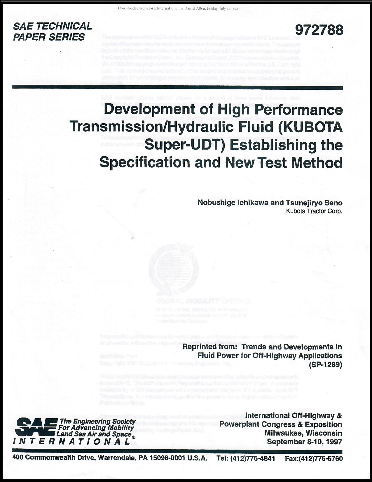

Just because valvoline produces oil for Kubota, doesn’t mean it’s the same stuff they make for other companies with a different label on it. Their is most likely some detailed procurement specification outlining the requirements needed to produce SUDT2 for them and even the lowest bidder would need to meet those requirements along with providing evidence of compliance to meeting the specification.
There is a specification for SUDT and it is not a secret.
Kubora UDT is just a typical UTTO that is not significantly different than any of the myriad of competing products from other blenders. Kubota has never claimed other wise.
SUDT is nothing more than an incremental improvement on UDT and the areas of improvement and qualifying test requirements are described in full and gory detail in this document. Buy a copy, read it, and the differences will be clear.
For those that don't want to go that route here is the Cliff Notes cheat sheet for the specifications document:
First and foremost there is ZERO discussion of anti-wear or EP additive performance. The new formulation is still a GL4 gear oil just like UDT and all of the other UTTO's being sold today,
The claimed improvements and associated performance tests are related to 3 specific areas:
  1. Viscosity - the new formula is lower viscosity and pumps easier in cold weather. Cinventional UDT is an ISO 46/68 hydraulic fluid with a viscosity index of 140. SUDT is now an ISO 32 hydraulic fluid with a viscosity index of 200. There are currently a bunch of competing products that fall into that category.
  2. Water tolerance - the new formula has a state of the art (ca 1997) rust and oxidation prevention additive package. Nothing earthshaking there. But it can also absorb greater quantities of water with out the formation of sludge or additive drop out that can clog filters. There are only a few products on the market today that make such a claim. John Deere Hygard (J20D) and CNH Ultraction SSL (Mat 3353) are two that I know of.
  3. Friction characteristics - the new formula has improved friction modifiers that improve wet brake and clutch performance resulting in reduced clutch/ brake chatter and squawk. This one is harder to evaluate. Every product on the market makes that claim. One of the Kubota qualifying tests is put it in the tractor and drive it. If the operator thinks it squawks or chatters it fails.
