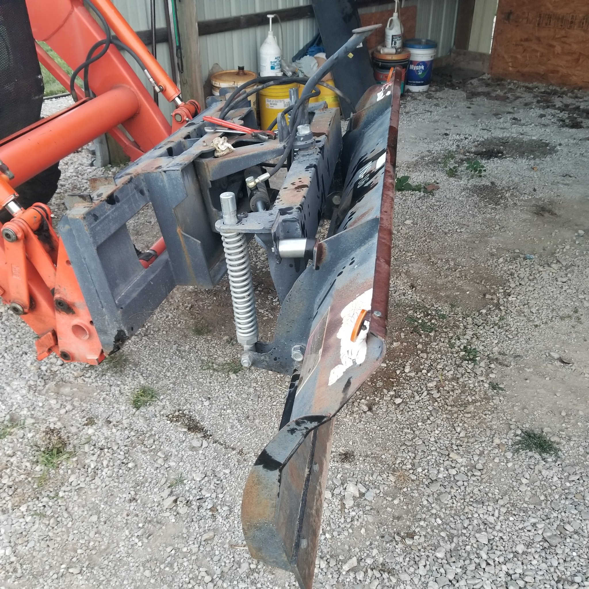

Gus, I guess the lesson for others to learn is beware of using other peoples equipment with hydraulic connections.
A couple of years ago I bought this blade. First thing I did was pick the blade up, remove hyd. lines and manually rotate to expel all fluid.
