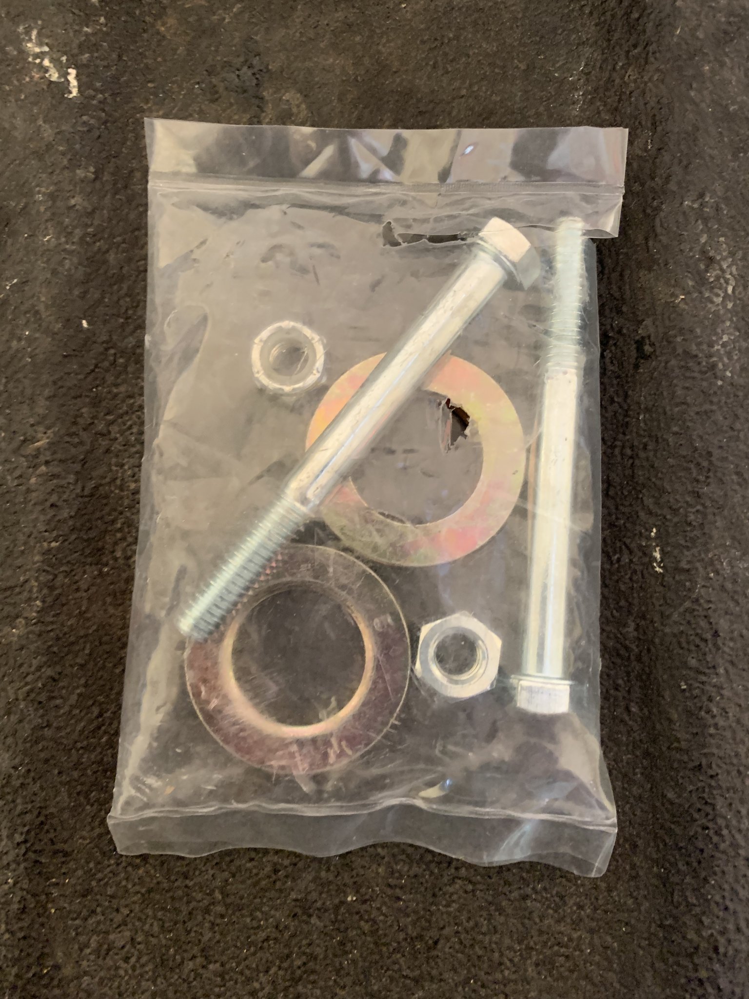

I installed one this morning on my L4060, love it! I had some bolts and washers in the kit but could not find any information in the instructions related to them. Any ideas?
10,124
4,179
nice, the manufacturer spends time and $$$ to make a pretty package of hardware and NO instructions what they're for ?? sigh....
I'd email the prez a picture of it( #3) and ask WHO was the idiot he hired to hire the idiot who made the package and wrote the 'instruction sheet'?
