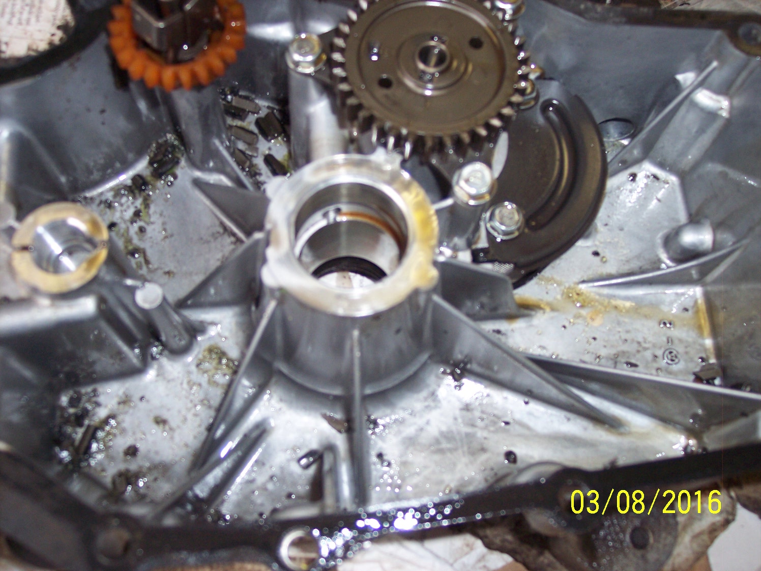

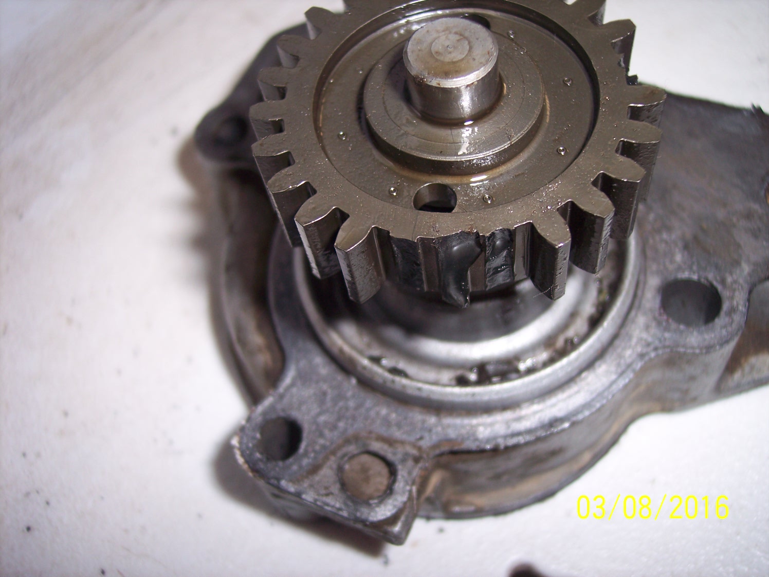

The cams were made with some kind of hard plastic material and after so long the gears teeth broke off the metal housing. The new ones are all metal.
Here's some pictures. The teeth also were peeled off of the oil pump. Had a couple of push rods that were bent.
