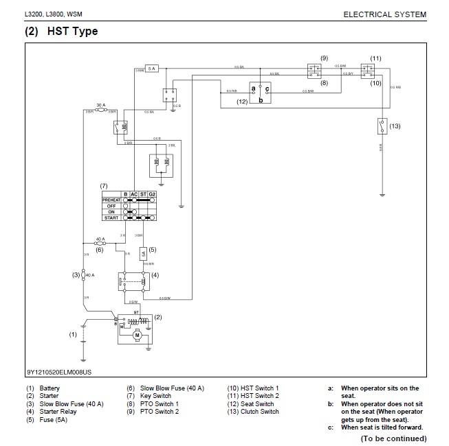

Here is the starting circuit description:
Can start: Battery current through three safety switches to starter relay and starter.
So there are three safety switches involved.
What I see is two circuits flowing through the HST pedal switch.
Two pto switches. Rear and mid perhaps.
Dave
Dave
Thanks for this. Helps to have a guide to go by.
