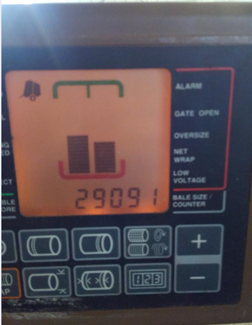

If voltage to sensor changes that much just from splicing wiring harness I keep my old worn rd baler that's baled over 29,000 bales.

If your round baler (looks like a JD) is still rolling rounds I certainly wouldn't change it out till you absolutely had to.
As for making a 5x4, 5x5 or 5x6 it's a simple adjustment on the monitor along with changing bale density adjustments....I apologize...I meant 5x6 not 6x7 on my earlier post. I am not aware of any 6x7 balers.

I fully understand your not stating bale size correctly!!
My rd 467 baler has baled only 297 bales this season. Limited # of bales this hay season due to lack of adequate local rainfall. I traded my previous JD 467 with 30,000 bales on monitor for present 467 in 2007.
