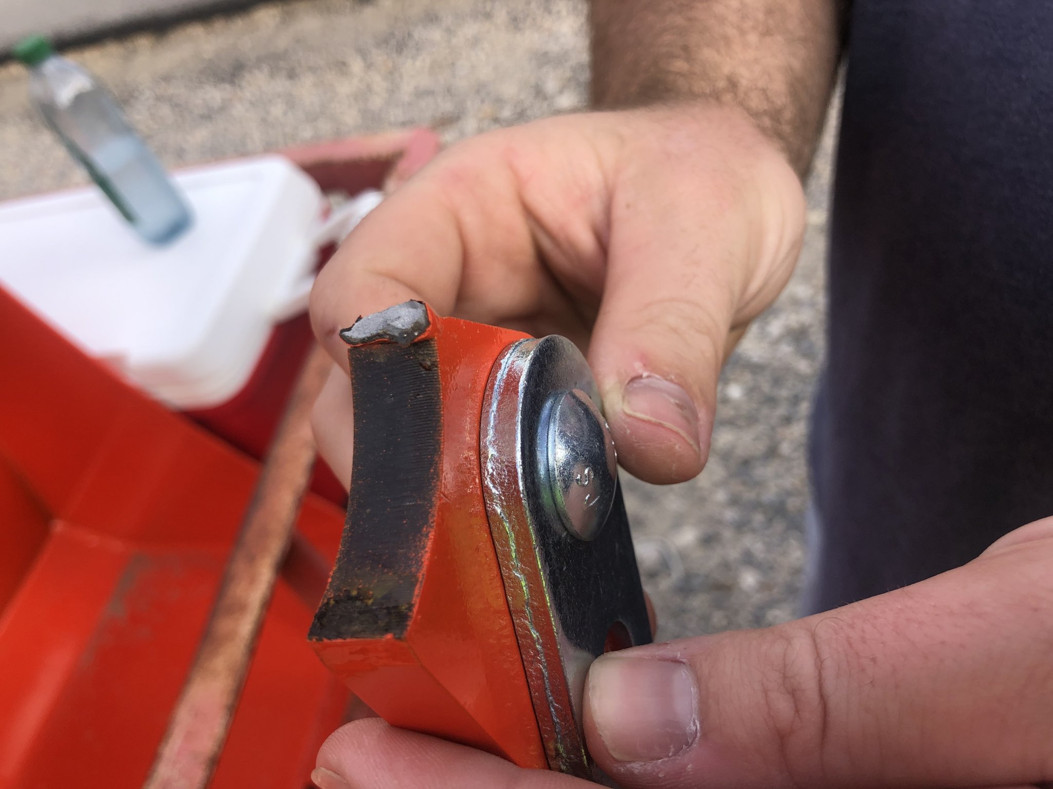

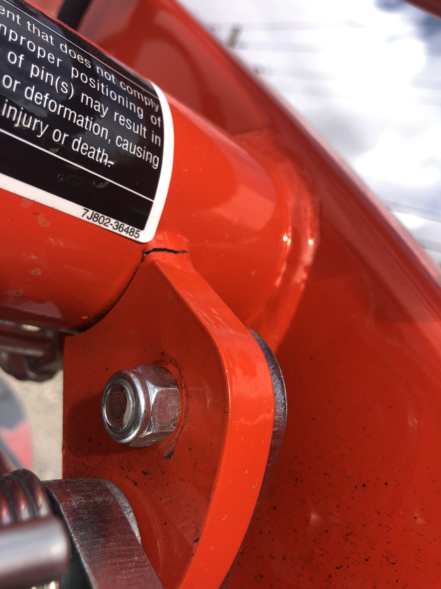

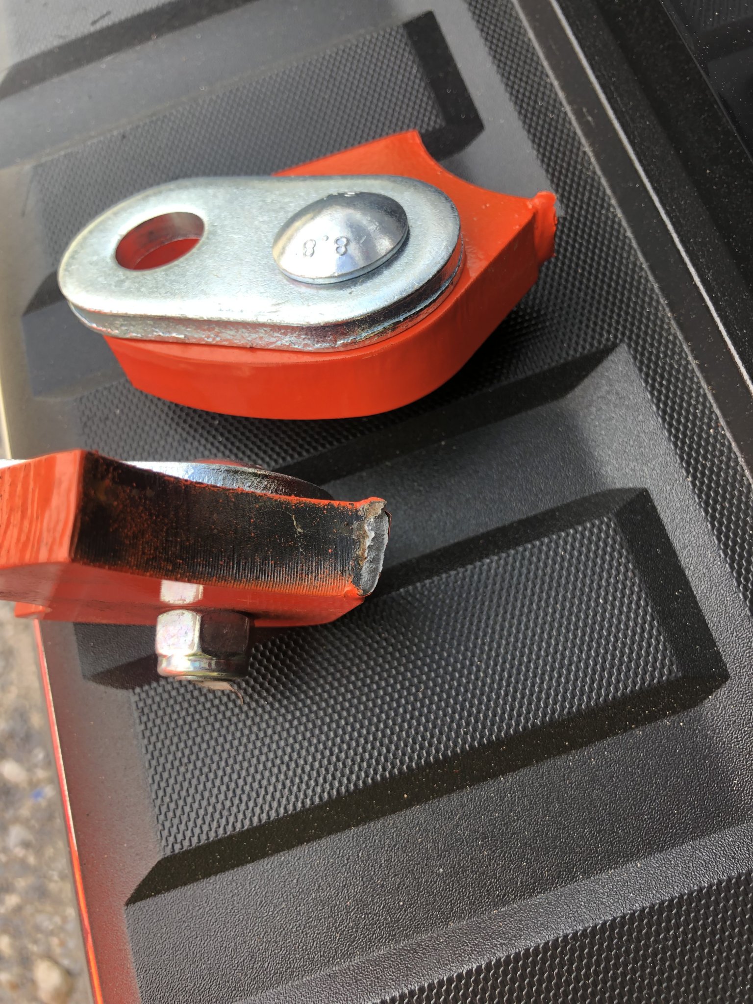

Thank you. I figured from the tag the loader may have been made in USA but it doesn't say that specifically. The dealer said the unit was welded by robot but apparently the process starts with the brackets being tack welded in place, and in the end only a small tack weld was holding on each bracket. The new loader has the brackets fully welded.

Makes you wonder what will become of the defective loader. Will the dealer just weld the brackets and paint and then put it onto another tractor, or will Kubota want to take it back for an internal investigation? I'll bet that the robot that screwed up will be fired, and their Christmas bonus revoked!

The dealer has been very responsive from day one, I have absolutely no complaints about them. This defect was costly to me though. I took two days off work to clear a half acre lot I own across town and arranged for the tractor delivery early Thursday morning to my home. My son and I drove to my employer Thursday morning to pick up a lowboy trailer before the delivery, about a 60 mile round trip. I'm not able to safely leave the tractor at the property so I needed to transport it. My lowboy needs new tires and rims but the 5 hole pattern rims could not be found locally. I wasted two days of vacation and 120 miles of gasoline because somebody at Kubota didn't do their job. This weekend the property was too wet because it rained for days so I still haven't been able to work with new tractor. Kind of puts Kubota in a bad light when you spend so much on something and couldn't use it.

And to the original subject….two fold IMO. First, the dealer should have probably caught the missing welds. Did you get a dealer delivery checklist? It should come with every tractor, in the packet with the owners manual. Not that welds on a FEL would be called out specifically…but it may give you some piece of mind.
Also never a good thing to know welds were missed at the factory. I suspect Kubota is having the same issues finding good help these days. Everyone wants more for less work. I have been trying to get my business insurance policies updated for 2 weeks…cant get anyone to call me back. What am I paying for again?

Salesman told me the unit had PDI done twice, joked about it going to cost them for one. He did not give me the copies of the PDI sheets. The first thing I did was purchase new grease gun and recommend impact rated grease and check all the fittings. We also torqued all the lug nuts per owners manual and checked all the fluid levels. When they gave me the owner's manual I asked about a manual for the loader and they said there wasn't one. I found the rotary cutter manual attached to cutter and ruined by rain so I downloaded a copy online. The box blade and fork attachment also had no manuals. The only manual I received from the dealer was the tractor owner's manual.

Except the dealer did not build it, Kubota did and they are the ones who failed to complete the welding.
I was in RV manufacturing for almost 20 years, I understand that when over 1,200 employees are building products mistakes happen. There were many missed opportunities to catch the missing welds both at Kubota and the dealer but quality control can't rest on the shoulders of a PDI at the dealership. Quality has to be a way of life not a slogan or poster, people have to live quality. I worked for a Fortune 500 RV company in the 1990's that had a quality program du jour, meaning it wasn't serious to them just a slogan or something to put on the brochure or hang on a banner that could change on a whim or by the day.

PDI doesn't include inspecting the welds, the mechanics are not qualified for that anyway.

I was a quality engineer and manager in a fortune 200 company. Kubota should have the quality systems in place to make sure the quality level is the same regardless of where the product is made. It is possible an operation was missed but there should be fail safes. if the robot did not cycle I would think the loader would not continue down the line without a manual override. only a guess on my part never saw a loader manufactured. Or maybe another boomer retired.

The tractor itself seems flawless. I was under the mistaken belief that the tractor and loader were made in Japan, but now I know the loader was made in USA. One thing I wish the salesman would have recommended was ballast. I was using the loader with forks to move pallets around my house and discovered without the rotary cutter attached the tractor is very unstable when lifting. I ordered a ballast box online which is being delivered Tuesday, I plan to fill it with pea gravel.
