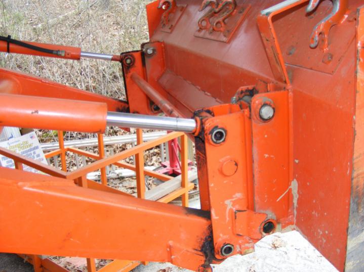

I was under the impression I have SSQA on my L3800. But what do the Kubota QA look like?
This is a Kubota QA. It simply hooks under the top pins on the bucket or forks, lift and install the lower pins and you're ready to work.
